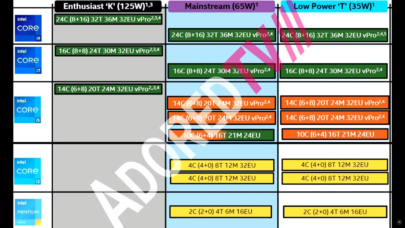

Intel is gonna announce 12th gen CPU series called Alder Lake with Big LITTLE cores just like Apple. It seems they are planning to increase cores by increasing only efficient cores. I was quite skeptical because of Big LITTLE cores but who knows?
Someone already tested with Intel i9-12900K which has 8 performance cores and 8 efficient cores. The score is 1893, 17299.
On the other hand, AMD Ryzen 9 5950X which has 16 cores without Big LITTLE cores. The score is 1768, 17588.
Surprisingly, 12900K performs as good as 16 cores CPU, not 8 cores CPU. Btw, M1's multicore performance was similar to 6 cores from Geekbench despite it has 4+4 cores.
This is mobile APU AMD 5900H with 8 cores.
So you may wonder, why not just increase the CPU core only with efficient cores? 12900K's multicore score is quite impressive especially since it's not 16 core CPU instead of 8+8 core CPU. The multi core performance is as good as 5950X but the wattage and heat might be lower than 5950X.
Intel is planning to increase only efficient cores for better multicore performance. It's 13th gen so it's not too far. Even 35W will have 24 cores (8+16). If the efficient core's performance is good for multi core tasks, then Intel's road map might be surprising as hell. So M1X might need to compete Intel with 16 cores or 24 cores.
But we might need to wait for actual test results later this year because Alder Lake is not released yet. This is why it's just a theory so dont yell at me right away. But if Intel proves it, then it would be interesting.
If the theory is true, Apple can just make Mac Pro's CPU by 8 performance cores + 120 efficient cores. It will be beneficial for multicore performance while the power consumption and temperature is lower than just 128 cores CPU without efficient cores. Both Intel Xeon and AMD EPYC already have slower clock speed anyway. But using multiple cores will increase the power consumption so it may not work with laptops I guess.
Thoughts?
