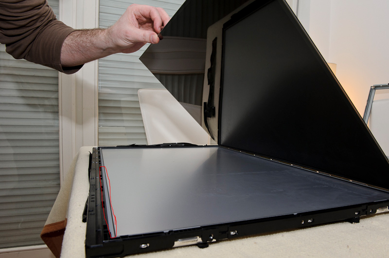

Be careful when while opening the frame. Try not to turn the display around too much. Even better try to open the frame while it's in one vertical position. I had one accident with one iMac (dead pixels) - but they came back eventually.
Be carefull when you lift the LED.
https://forums.macrumors.com/attachment.php?attachmentid=287667&d=1306956612
There'S the dust!
https://forums.macrumors.com/attachment.php?attachmentid=287668&d=1306956612
Clean it very carefuly!
https://forums.macrumors.com/attachment.php?attachmentid=287669&d=1306956612
And at the end put everything back. Be gentle! LED can easily breake!
https://forums.macrumors.com/attachment.php?attachmentid=287670&d=1306956612
https://forums.macrumors.com/attachment.php?attachmentid=287671&d=1306956612
Good luck!
Oggy

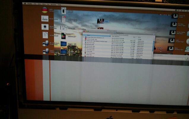

clean imac but ....
Hi !
Thanks Oggy for the tutorial ... i did that succesfully, no dust. But ...
I have a straight line from left to right at the lower part of the screen. Not dead pixels cause if i move a window i can see this line changing so it looks to me that it reflects other pixels like this row is positioned in a wrong place ...
Is it caused by a damaged electronics of the display or just bad assemlby after cleaning it ? or maybe damaged LCD ... ?
Thanks for ideas ....

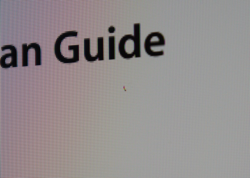

Strange Problem fixed thanks.
I used this tutorial to fix a strange issue with my imac 27"..check out the photo..a piece of tape that is part of the screen assembly found its way onto the diffuser screen...strange..and annoying as you can see from the pic.
Anyway following the guide i simply unstuck the tape (which was thin and grey..the tape runs around the edge of the screen.) and placed it back where it should be (it has a tacky back..no idea how it moved perhaps heat)..so its not just dust that can find its way onto a screen.
I've borrowed the pic earlier in this forum to highlight the taped area (mine was on the right hand side)
For me it was a anxious but pretty straight forward fix for what i see is a rare problem! Thanks to the tutorial here..so thanks.

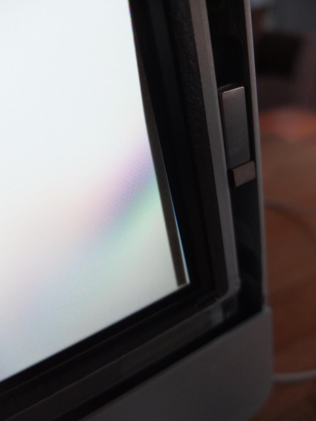

Thanks Oggy for pioneering this way of d.i.y. cleaning your defective iMac screen . I was having this smudge problem since I bought the 27" iMac secondhand and was dreading executing this kind of risky cleaning myself. Yesterday I finally had the courage and after 1 and a half hours sweating/cursing I am now posting this from an all clear like new iMac.
Thank you guys.:D
So, I did this. Almost all the spots are gone. So it's all clear now.
However, when reassembling, I found the frame (with the magnets) to be slighty bend making it hard to get the screen in. Now all is good but slighty forced.
I did however got a sudden kernel panic at first boot up (2 minutes in or so). I think it has something to do with one of the LCD cables not properly plugged in..? because the screen went black then came on and then the panic came.
