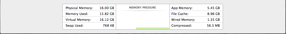

It's normal to have some trivial amount of swap, even with oodles of RAM. Here's my current state with the system up for 24 hours. I don't know why yours is higher, but maybe you did something earlier that pushed it up a bit.
I like Mavericks memory management. Mavericks pretty much holds onto whatever it can in the File Cache, which freaks a lot of folks out, but it makes sense to use the RAM if it can. Why purge something I'm not using at the moment, but used a few hours ago. I might use that program or file again. But if I open a Parallels VM to which I've assigned 8GB of RAM, it'll purge whatever it needs from the cache to make room.

We don't know your uptime, and since your file cache is on the low side, it looks like some other apps were using the memory, caused a page write & purged file cache, and when terminated, used memory fall back..
i think this might be the case. although with that much RAM available, I'd hope Mavericks would move it into RAM.

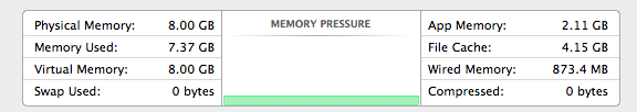

Maybe the OP does have a problem with his memory management. I've been running my computer for over two days, and my computer hasn't used any swap. I've played pretty intensive games and used photoshop and indesign as well. Here's what mine says.
Also, this is with seven tabs on safari opened, Airmail, Messages, and VLC all opened. Nothing big opened right now, I guess, but still no swap with my prior uses.
