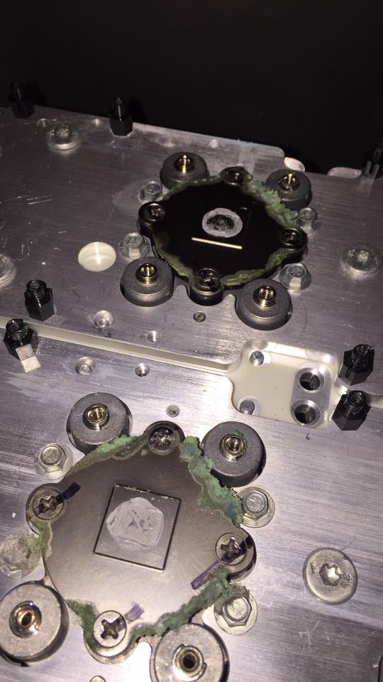

Okay so, time for a bit of explanation about the air cooling mod. So basically, it's about junking the LCS and putting some heatsinks in its place.
More info here:
http://aquamac.proboards.com/thread/1290/powermac-g5-lcs-air
I got one 2x2.7ghz and one 2x2ghz machine delivered to my house by a local seller for an outrageously cheap price, so no complaints. The 2x2ghz was the model that only takes 4x1gb modules max (half the spaces on the board for RAM have no holders soldered in!) but the 2.7ghz model had 8 slots. Both machines worked but...
I noticed that, even though the 2,7ghz model was working, there was green corrosion around the pipework for the LCS. On taking the LCS off I saw this!:
... there was also green corrosion all over the CPUs and the motherboard. Looks like I caught it just in time.
So I binned the LCS, cleaned all the corrosion, got the heatsinks from the 2.0, cleaned them up and put them on the 2.7 with new thermal paste.
I've since swapped the CPUs back over to their original slots and everything works fine! I've had the computer on a few hours this evening, running cinebench R11.5 for quite a while, and downloading updates etc at the same time to stress the CPUs. The 2.0 heatsinks seem to be more than capable of cooling the 2.7ghz CPUs, after I turned the machine off I took the side panel off and felt the heatsinks, they were barely above normal temperature and while the machine was on the fans only revved up a few times; even then they didn't get loud.
So I now have an air cooled 2.7ghz x2 - I'm happy with that 🙂
