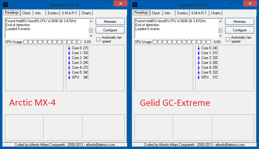

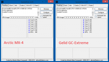

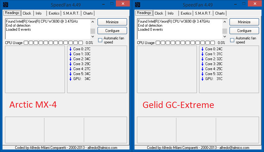

Thanks for recommending Gelid. I just applied GC-Extreme to my CPU and GPU and temps are down 1-3° C across the board compared to Arctic MX-4.
