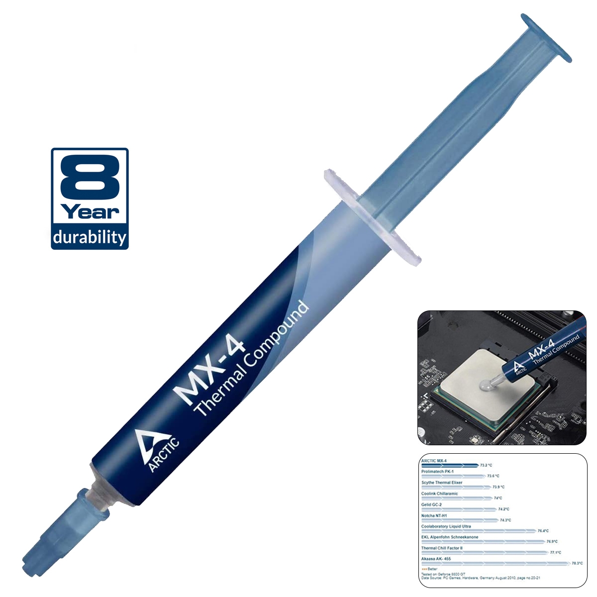

My personal preference is Arctic MX-4, as it is not electrically conductive and will not ruin anything if it spills onto any circuitry. It also does not need any "curing time" like Arctic Silver 5. Not only that, it ships in a much larger syringe than Arctic Silver 5, decreasing the amount of times you need to restock when constantly making new applications of paste.
I also feel like I've collectively gotten lower temperatures from use cases with it as opposed to when I used Arctic Silver 5.

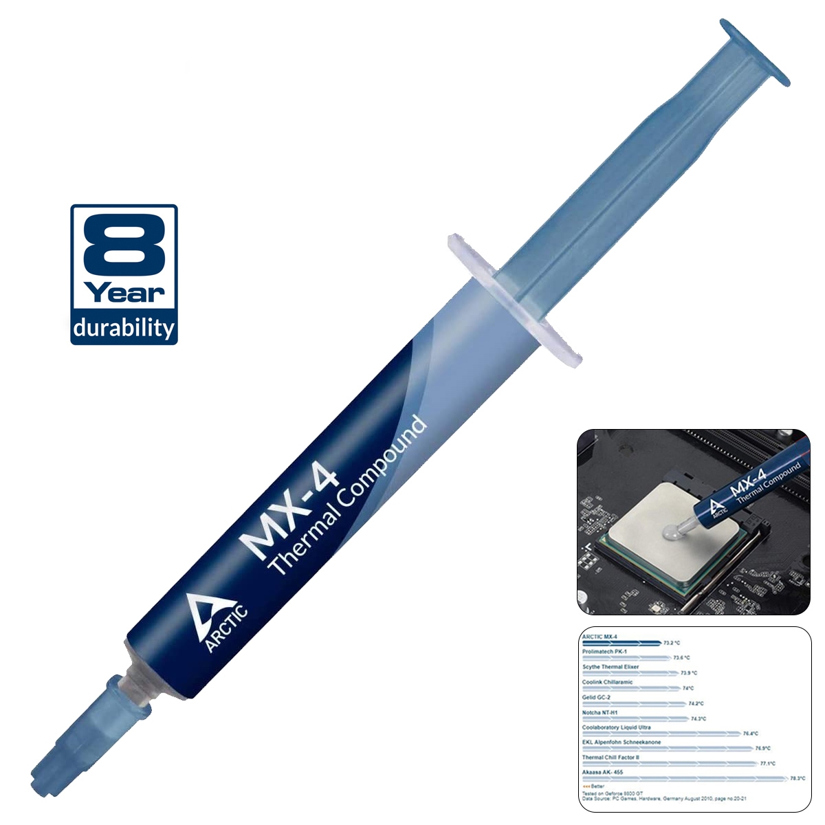

An important thermal paste spec to look at is the longevity it has, and many don't even list that. Longevity really speaks to the overall quality of the paste. That's why I always use MX4. It's rated for 8 years, but will easily do 10.
