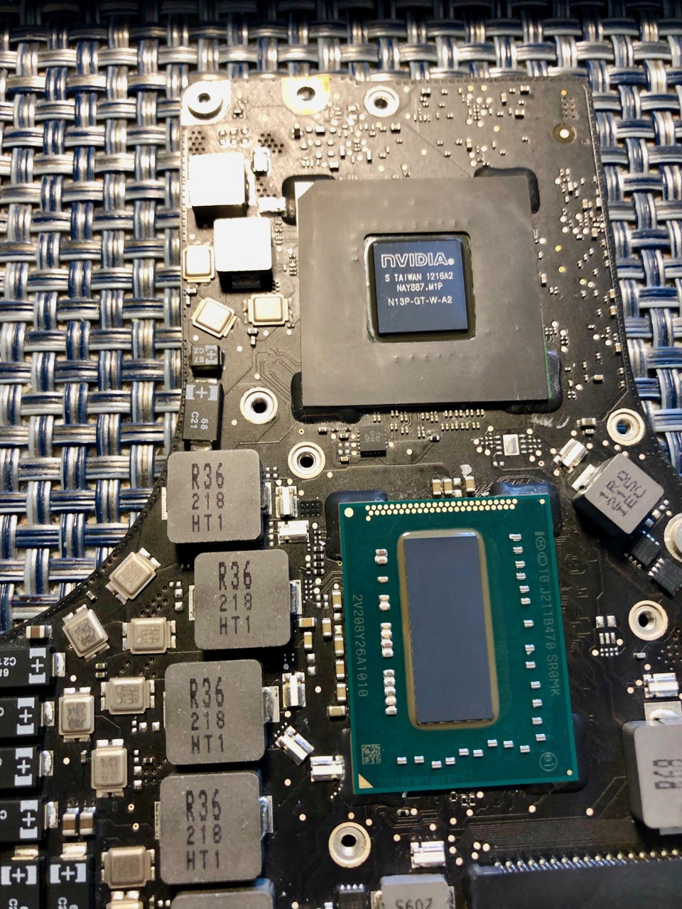

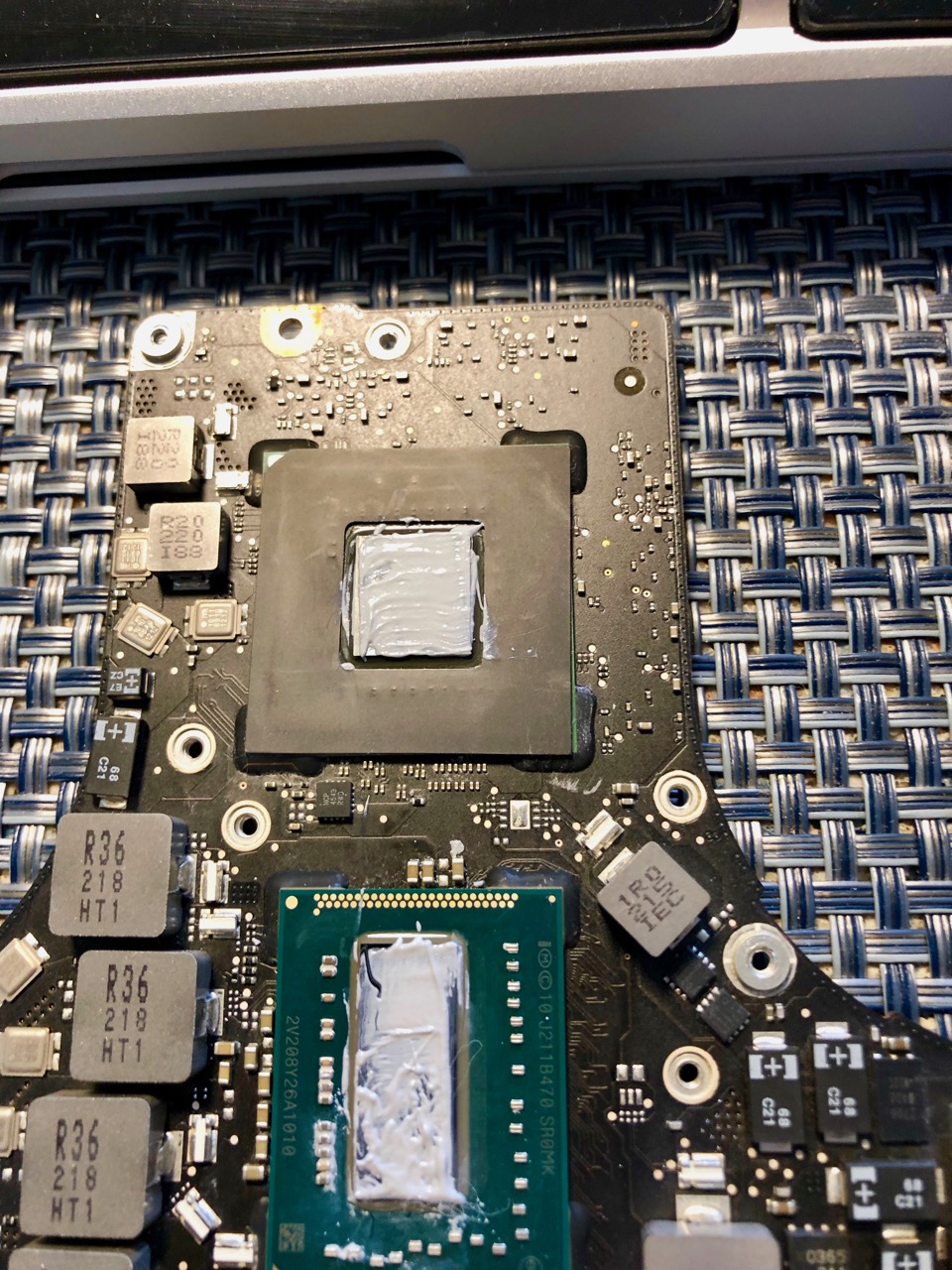

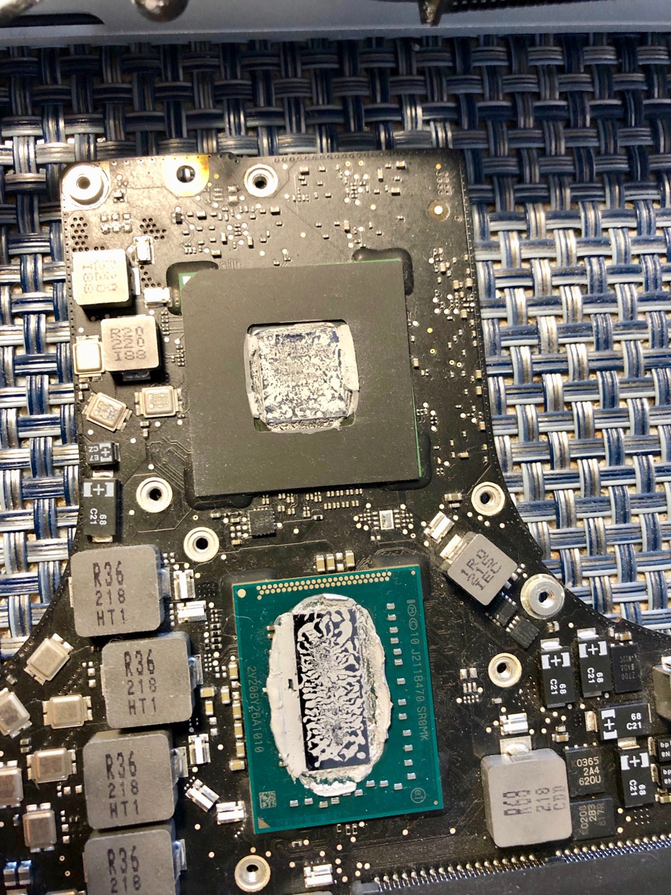

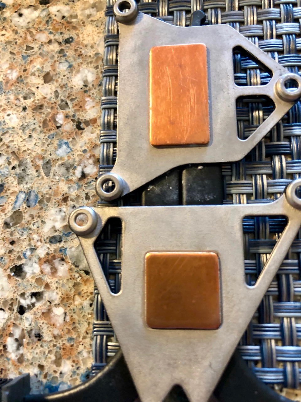

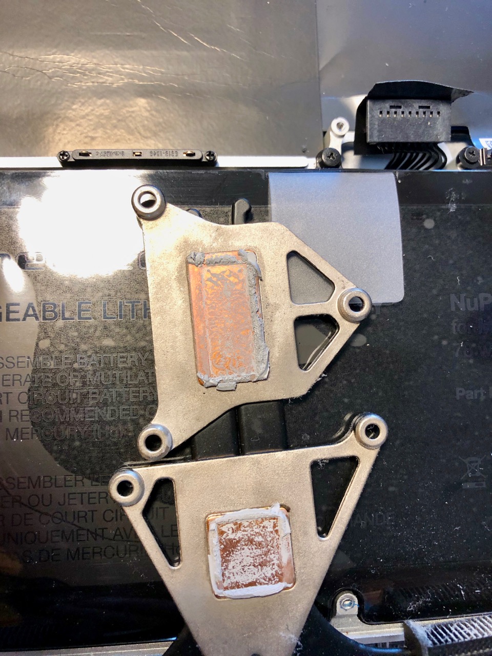

I have a 15" MBP Mid-2012 that was showing high and large swings in temperatures +70ºC - +80ºC doing normal day to day work stuff. Decided to do a re-paste. I followed the ifixit process. I was concerned about brittle cables because this laptop is on 8-10 hours a day. Glad to say everything went well and temperatures have dropped to 60ºC range.
Origanal paste was brittle (excess amount as @shardey observed). Cleaned up with alcohol and arctic clean. Artic clean is worth it, it removed material I could not see and the alcohol did not remove. Added Thermal Grizzly Kryonaut grease.
