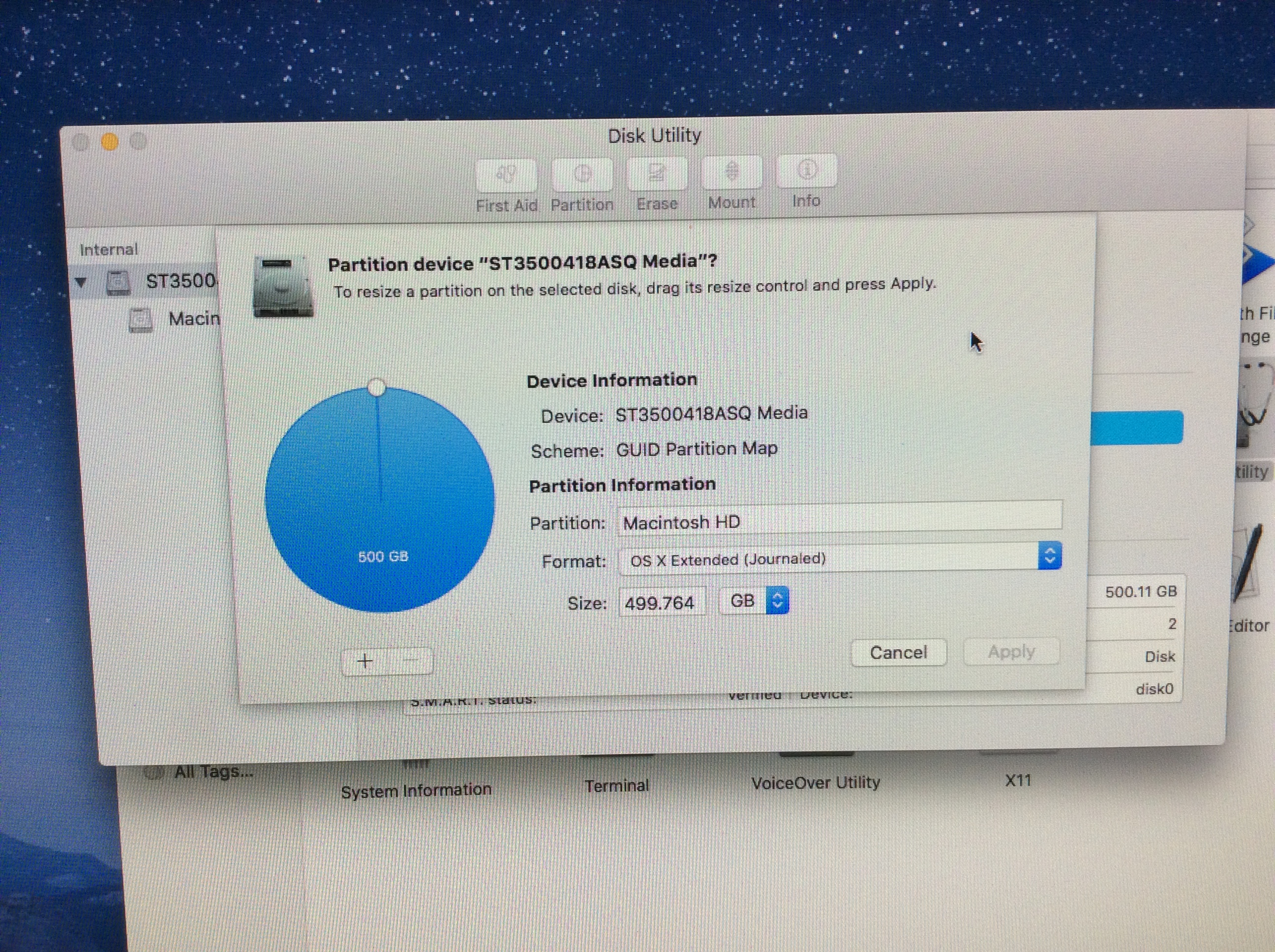

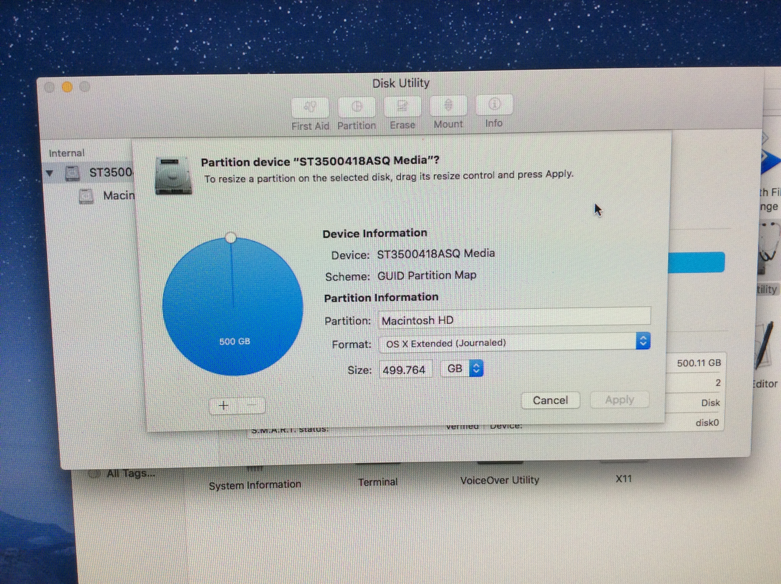

Quick question. What does DU say about the capacity of the hard drive now? Using DU sometimes to remove BootCamp does not make available the wiped space.
There was some partition space that couldn't be resized at first but after enabling journaling on it I was able to remove it and then performed first aid on the drive. Now boots fine!
