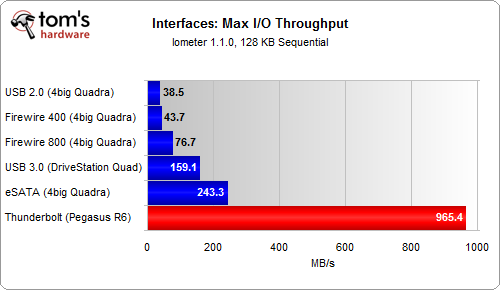

This may help:
From Thunderbolt's Bandwidth: Sizing Up To USB 3.0, FireWire, And eSATA : Everything You Need To Know About Thunderbolt

USB 3 external SSD is almost as fast as internal SSD, depending on which enclosure you get.
