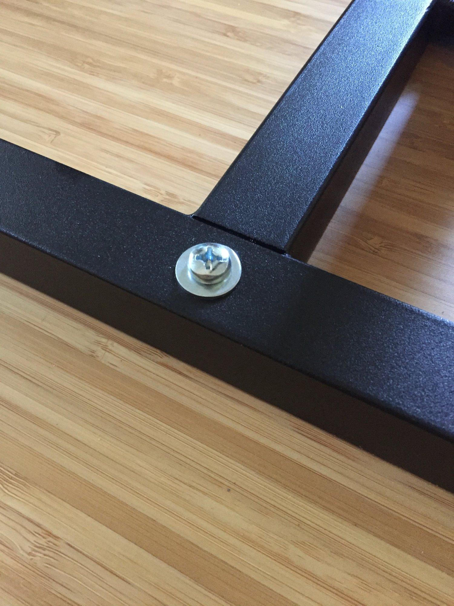

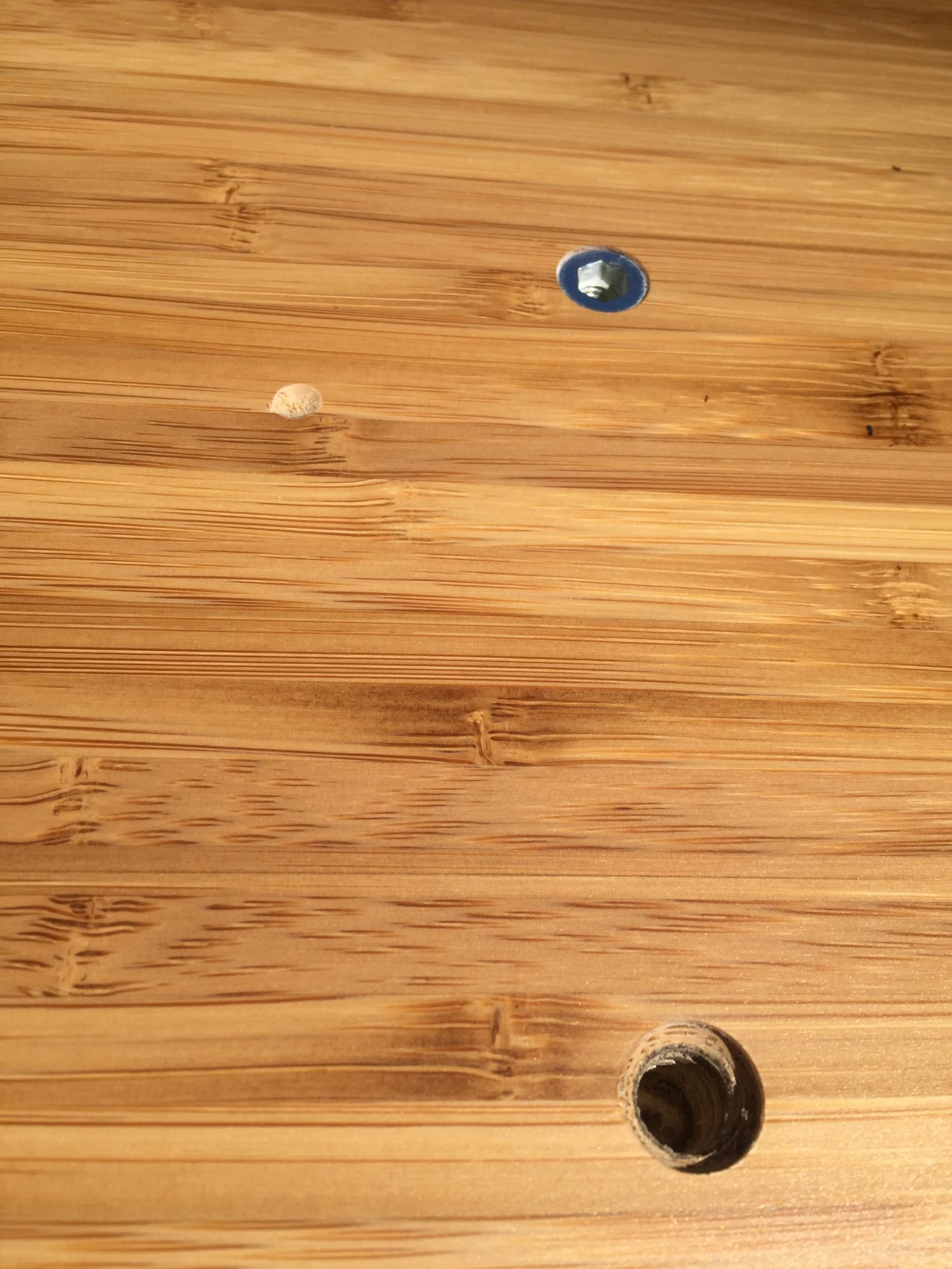

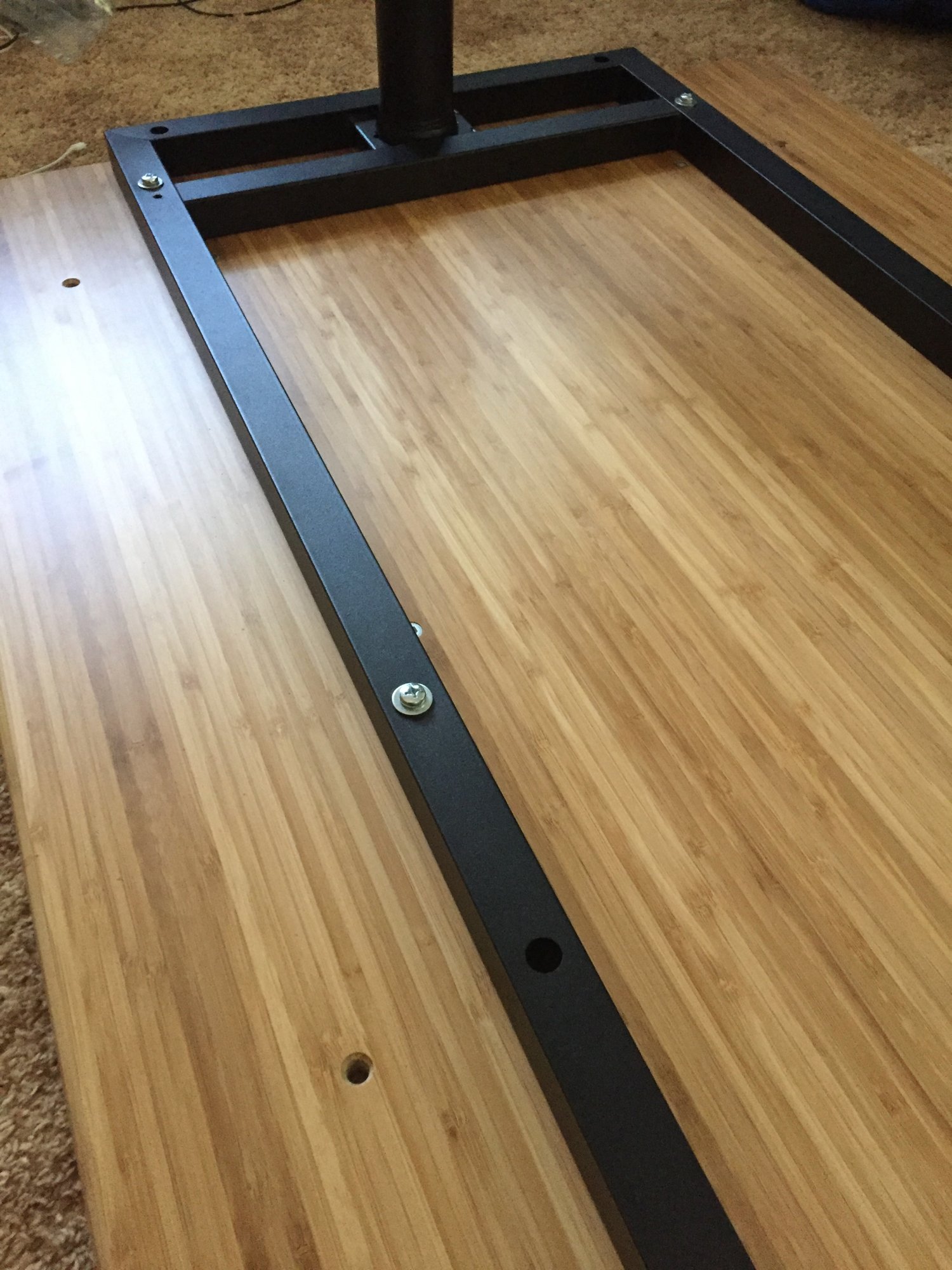

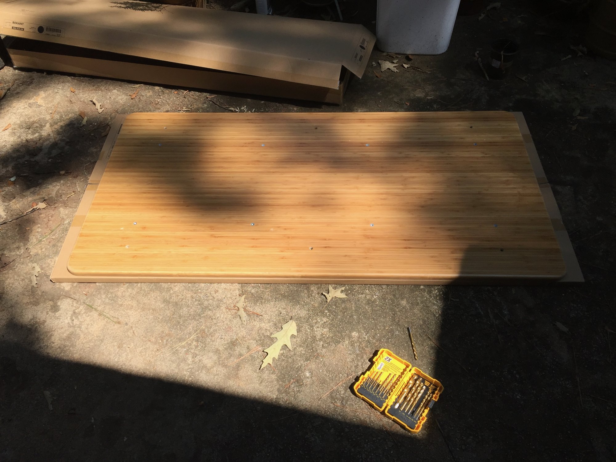

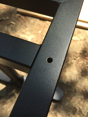

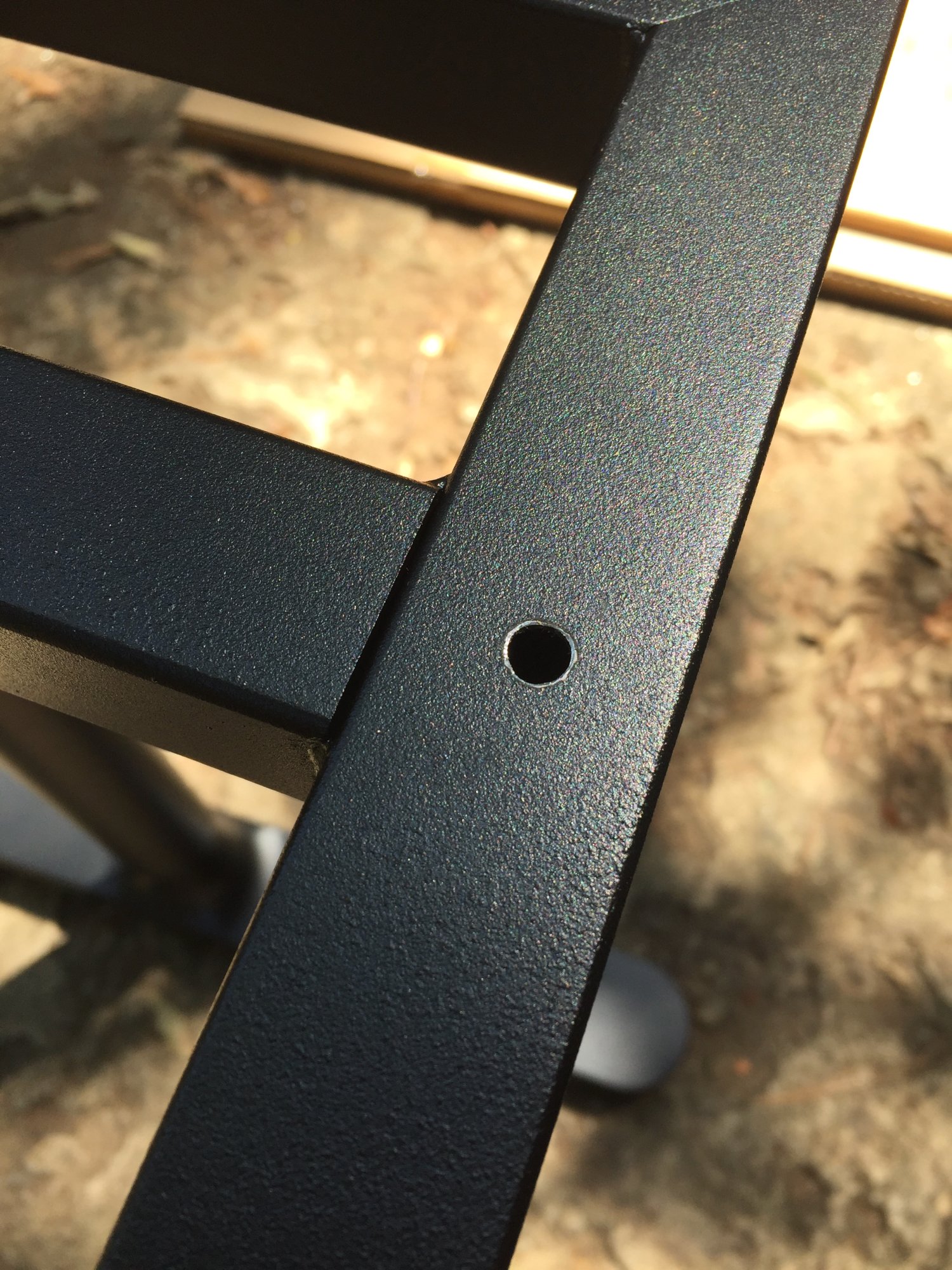

I faced a similar task a few years ago.
Having been previously satisfied with my current desk (the Make:Model currently escapes me), I endeavored to purchase the same a few years later.
IKEA--being IKEA--cycles their Products, and phases-out/introduces-new all the time.
What I had existed no more!
I had to make-do with purchasing an (un-related) stand, and table-top:
I don't remember the names of the un-married products, but it was a definite challenge to get the base to align to the tabletop.
The main challenge was that I had to drill new bores into the tabletop, into which I inserted the grommets mating the stand to the tabletop. I did a lot of measuring, and aligning.
IIRC, I had to drill new bores into the stand, as well.
A worthwhile adventure, which produced a very usable product 😉

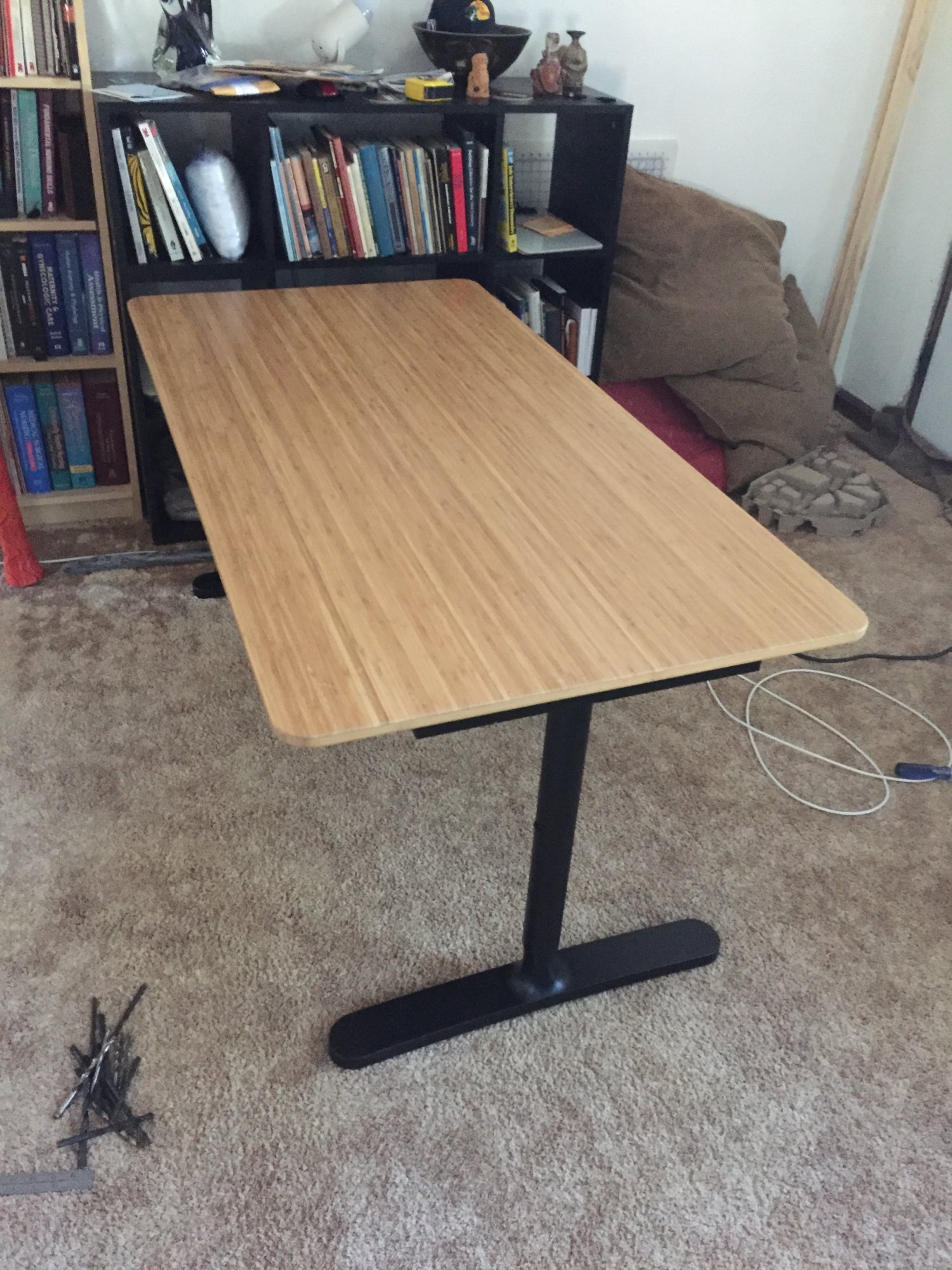

@splifingate That looks like an IKEA Bekant top and legs.

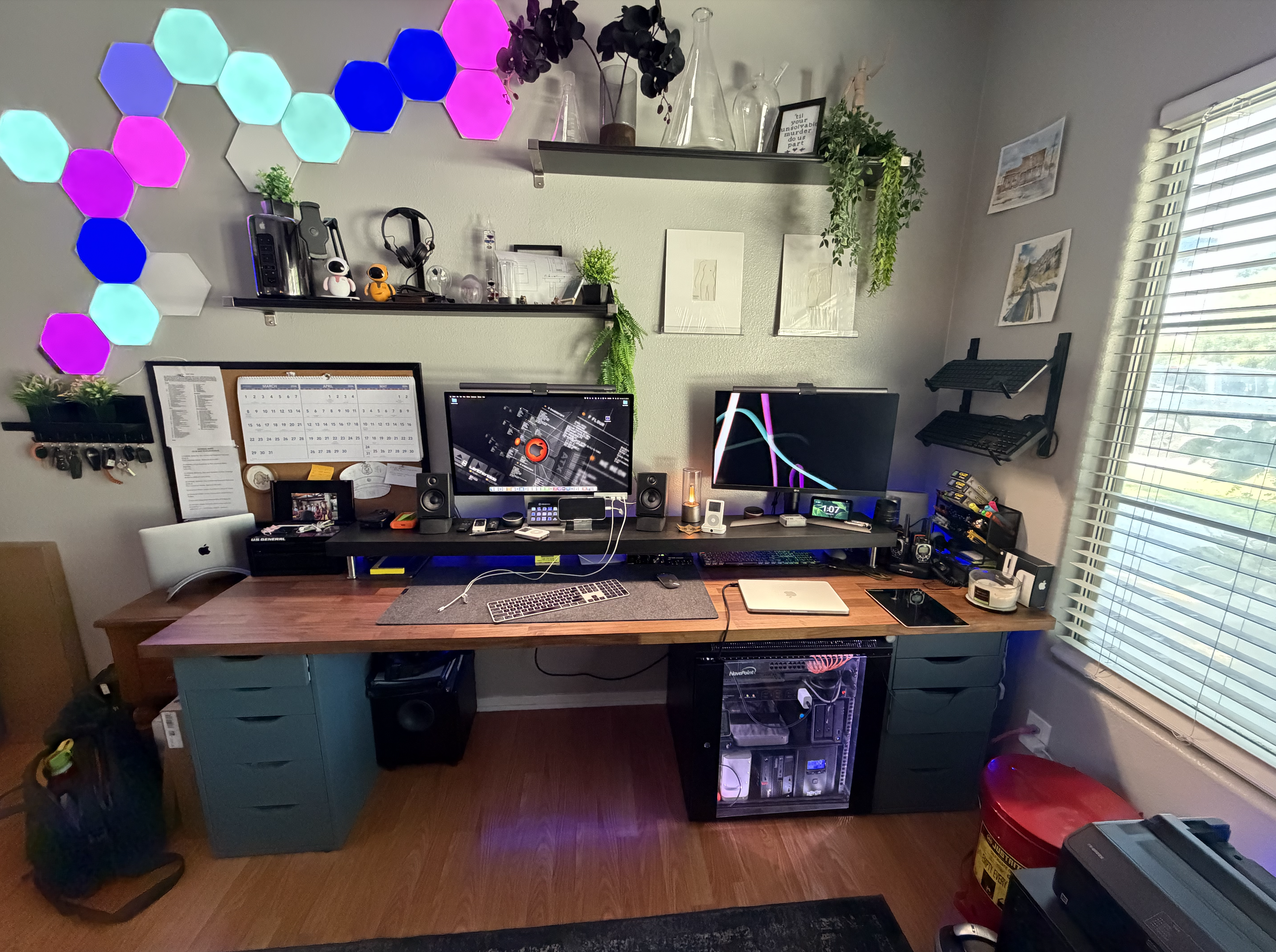

You pretty much described my setup. Pictured the day I built it, and a few days ago.
Mine is the 98" top. I would say it was about 100lbs. It was definitely easier to bring in with 2 people. I dont believe this is veneered particle board, it feels way too solid. I believe it is bamboo as the post above mentioned.
I havent run screws through my cabinets into the bottom of the counter top yet. As it usually takes me about 2 years to finally settle into a "permanent" set up, so Ive held off. But I will be doing that soon. The top will slide around if bumped. This is especially the case for me as I have base boards at the floor and do not keep the desk top pushed against the walls. So I have room for cables and some distance for my back lighting.
Ive had no issues with sagging, it's been set up for about 2 years now. But I did use some cabinet risers/feet from Ikea along with the Lack floating shelf to build a monitor riser, so the weight of the displays are more over the cabinets. YMMV here.
I came here after having a Jerker for 10 years, so I definitely do not feel like this desk is deep enough. Even with the monitor shelf for more space, I wish it were about 12" deeper. But it works fine.
The top rests flat onto of the cabinets, ,and I have about a 2.5" gap between the top of my rack and bottom of the desk top. Which works well for the fans on the top of the rack cabinet.
Cable management, I just have the cables routed fairly nicely and tied with velcro at regular intervals behind it all. Most everything runs into the rack for power or connections anyway, and with the monitor shelf and gaps, I dont have many visible wires. Though a more thourough arraignment will be made eventually. Like I said, it took me 10 years and 4 moves to perfect my Jerker set up. This is an ever evolving thing for me, and my desk setup is a hobby in and of itself.
Im open to any questions you may have.

This is fantastic! Where did you get the desktop from? (the drawer stacks look very IKEA). I just got a roughly 66x36 piece of 5/8" ply and lacquered it up and put it across two half height file cabinets. The extra thickness on the slightly lighter wood stock makes sense for this longer span.
It's all from Ikea. Drawer units, the top (I think it's 29"x98", and solid. Was sold as a kitchen counter top.), a Lack floating shelf, and cabinet risers/feet.
I also use a TV stand/cabinet, also from Ikea, as a printer/laptop charging station. Yes, that is a dot-matrix printer, and yes, it actually gets used significantly more than the ink jet. Good old Federal Govt forms with 5 carbon copies. I work in hazardous waste, I think my industry alone keeps the suppliers of feed roll paper in business still.
