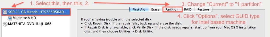

First, you will need a Philips head screwdriver #00 and a Torx T6.
As mentioned above, with a new HD installed, boot up with the "c" key held down (tells the computer to boot up from the DVD drive).
Before doing the OS installation, use the "Utilities" menu, and "Disk Utility" to partition the HD (completely not related to the Momentus XT's 4GB of SSD), see the attached Preview file for some more details.
You should have an easy time doing this, it sounds MUCH more complex than it really is.
Warnings: Some of the screws holding the back on are really small. Be careful to not let them escape to the floor! Also, be sure to get them back in the same location they came from, there are different lengths.
Be careful not to let a rampant screwdriver gouge the soft aluminum back.
Good tinkering 😎:apple:😎
