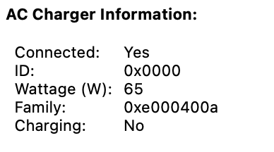

A little late to the party with this one, but I'm using a UGREEN charger, and getting a charging rate of 65w using my MagSafe cable.
Should also add that this charger is grounded so TouchID works as expected. I was using a cheaper 3rd party charger before which was a right pain.
