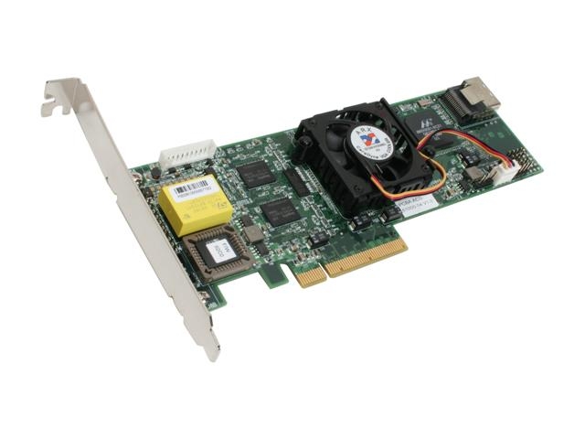

I just bought a third party RAID card from Accusys (ACS-61000-4).
I heard about this card from Accusys at MacWorld last week and they assured me that the card would work in my Mac Pro. I tried installing it tonight (boy was THAT fun) and the "iPass" cable is not long enough to reach the RAID card. Apple's RAID card is much longer and is closer to the first hard drive bay, thus the iPass cable can be disconnected from the motherboard and connected to the RAID card. The card I just bought doesn't even make it to the middle of the machine and so the iPass cable isn't even close to making it to the Accusys card. I looked at many of the other RAID cards out there and they all seem to be of the "smaller form" like mine.
How can I extend the iPass cable so that it can be connected to my new RAID card? Has anyone else successfully installed a third-party card into their Mac Pro?
Thanks guys!
I talked with Accusys and they said that you can actually switch the bay 1 and bay 2 hard drive connectors which will give you enough space to extend the original iPass cable. They did say that you can't just connect the RAID card into the MacPro and have it work for you. You need to do this intense workaround to get the correct drivers in your system/RAID card/Hard drives. I'll go ahead and paste their response below.

Rerouting the cables for drive bay one and two to give you some more slack, works well. Just be careful when unscrewing the screws... they can easily fall into your computer (I did this twice!).
BTW- This is cheaper than buying a cable but if you wish to extend the ipass cable, then here is a link to a product that does this. I haven't tried it though:
http://www.maxupgrades.com/istore/index.cfm?fuseaction=category.display&category_id=332
