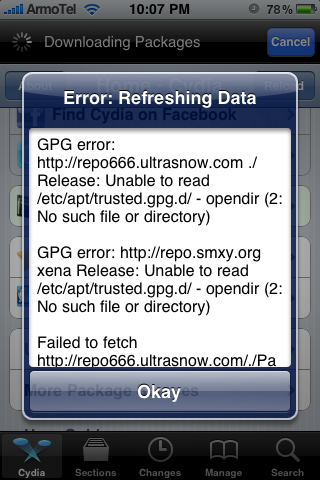

I wanted to install the "Ultrasn0w" source on Cydia (thinking that I can use it to Unlock my 3.1.2 with 5.11.07 bb. 😛)
I made the common mistake of typing the address "http://repo666.ultrasn(o)w.com" with a "o" (oh) instead of a "0" (zero).
So every time I load up Cydia I get this stupid ERROR Message!
How do I tell Cydia to forget about that link and to stop trying to connect to it?😕

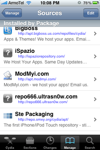

I went to "manage" to delete the specific source or whatever, turns out it doesn't exist...(and I cannot even delete the actual "repo666.ultrasn0w" source either)
I have no way of stopping this, it is getting annoying every time I run Cydia to see this pop-up.😡
I don't want to restore and re-jailbreak my iPhone just for this stupid pop-up, I hope there is a less drastic way to get rid of it, anyone? please... thanks in advance

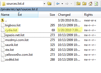

Bdubb: this is really a completely different topic, and in future you should make a separate thread (although this has been asked before...)
You need to check each of the files in /etc/apt/sources.list.d for the offending entry. If you find a file that contains only that entry, delete the file; if it contains other repositories, edit it to remove the misspelled one.

Ok file edited, stupid false link removed! thanks once again, The one and only Latinist!
EDIT: Ok I think things are ok...😕🙁😱
