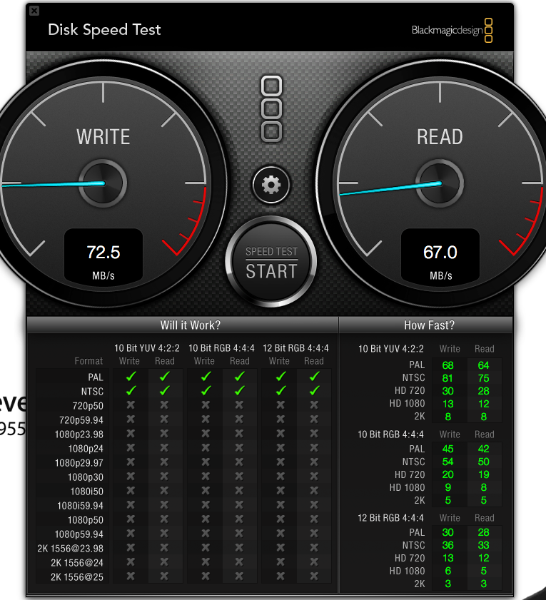

Use something like black magic disk speed test
Had it run for over an hour before I took a screen shot. I don't know what's good results so if you could explain that would be great. I have the 750gb HD that came with the 2011 15" MacBook Pro.
Your results seem average, not great, but not terrible.
There's definitely a hardware problem, likely still the hard drive.
