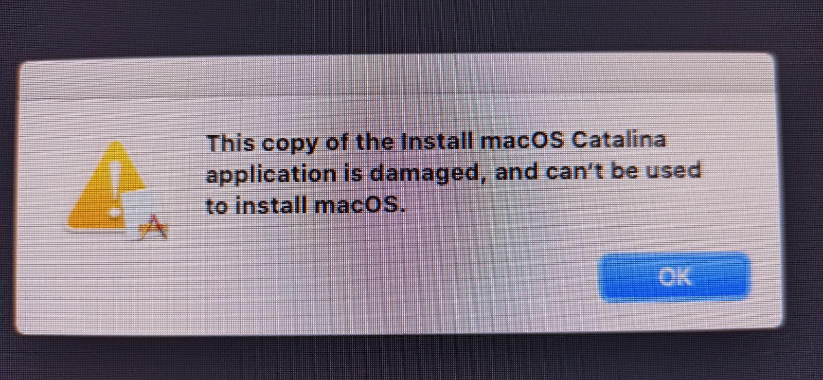

Help! Im trying to install it on a mac pro 3,1 the creation of the usb installer went all ok without errors but after boot I get the message (This copy of install macOS Catalina application is damaged, and can’t be used to install macOS. Btw I had previously installed it in the same machine with the same method. Just this time I get that error message. Also the creation of the bootable USB with the patcher went ok.

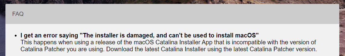

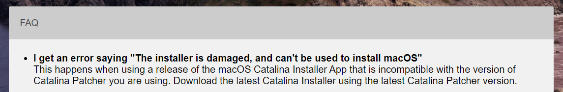

Make a fresh bootable installer:
Download Catalina installer again.
Make sure you have the latest version of your dosdude1 Catalina patcher app (currently version 1.4.4)

thank you. That worked, I don't get that message anymore. Only now I get this other message. Any idea what it could be? Very appreciated
