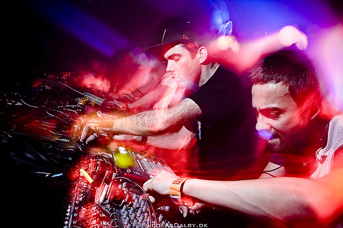

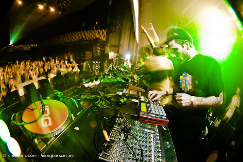

I was recently browsing a friends facebook and noticed an image that caught my eye, how would i go by getting this effect? where only the lights are moved and not the person?
low light, shutter is open for more than a split second and he/she likely moved the camera to get the streaks of light from the board.
Yes... and maybe use a tripod... moving it just before the end of the exposure (needs a bit of experimenting)...
True but the way it was moved tells me it's possible there not a tripod because it twists awkwardly.
It may have a rear curtain bounce flash in order for her to be mostly sharp.
I was thinking along the line of a flash also. Too much of the image is sharp and the lights are blurred quite a bit. Flash with a 1/10th sec exposure?

The technique/effect is called "dragging the shutter". Try googling it and you should come up with alot of info.
He probably used a shutter speed around 1/10th like mentioned in this thread.

For that effect you'd need to drag your shutter as mentioned above, with a 2nd curtain sync flash at *maybe* a stop lower on the Ev (hard to tell from the picture exactly).
The reason for 2nd curtain sync is that it fires the flash when the shutter is closing, so that the subject, in this case the DJ is exposed along with the additional light elements exposing throughout the frame. She was likely unlit without the flash, and at the moment the shutter closed, the flash exposure caught her in the shot for the effect as well.
Actually I think it must have been 1st curtain sync by the looks of it. Notice how the lights are "drawed on top of the DJ" instead of under her which would typically have happened with 2nd shutter sync.
Generally it very difficult to capture the precise moment you want to with 2nd curtain sync. Maybe not so much with shutter speeds around 1/10th but any longer than that and you might miss the situation with 2nd curtain sync 🙂

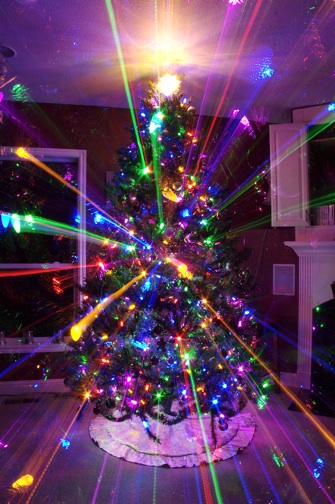

Like others have mentioned, they are done with flash, most likely bounced off walls or pointed but diffused at the subject. Here are some quick snaps of the tree (not done decorating!) in my apartment. Aperture was at 2.8, shutter at 1/10th.
Here is a shot with a little arm movement:
Here is a shot with a little more arm movement, quite a fast swipe, the pine cones are surprisingly in pretty good focus considering the motion of the camera at 1/10th:
Here is the set up, except the tripod wasn't there as I hand-held it to do the side-swipe motion. The flash on the ground was triggered by the pop up flash on the camera, bouncing into the white board:
One of the drobo, another crappy one, getting a good light pattern takes well executed arm movement!
Off camera flash bounced off wall:

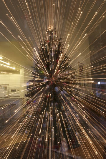

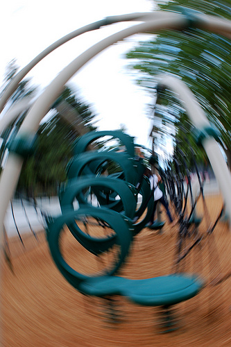

Try this effect
Yes, slow shutter speed, but try zooming in/out. Very fun. 🙂
