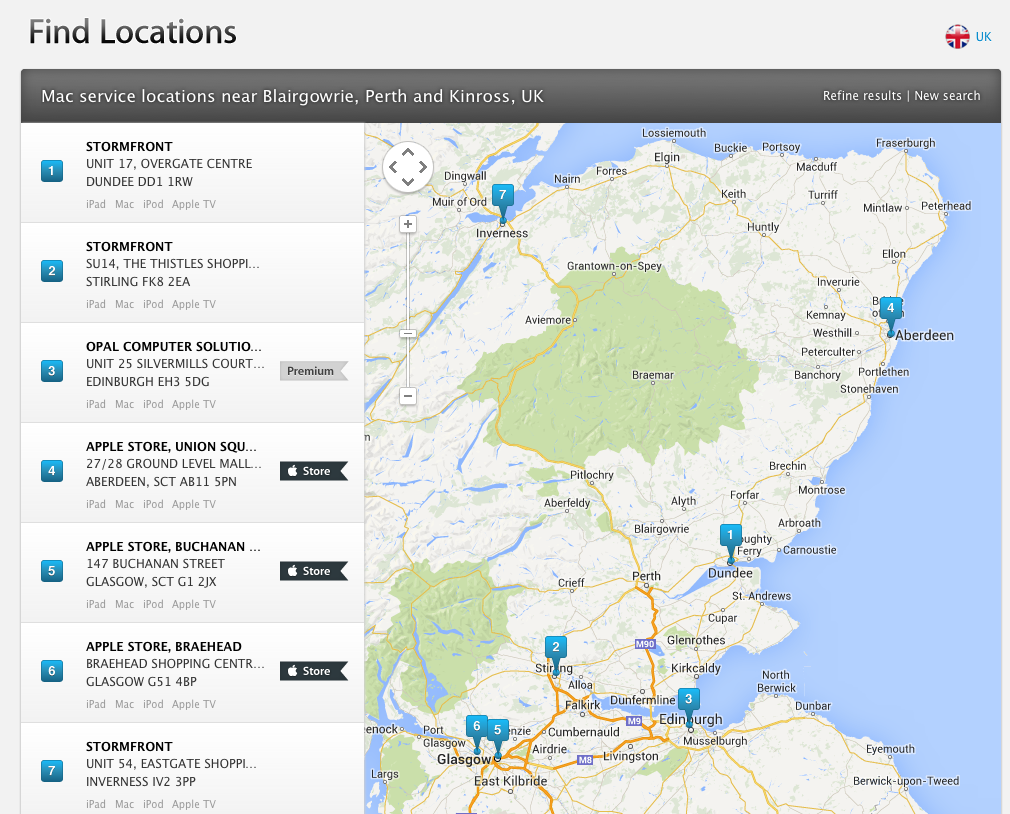

By using this: https://locate.apple.com/country
I found that in nearby Dundee (South East from you) there's an Apple authorized service shop.
After three months since the start of this thread, it appears that you can't figure out what to do with the easy problem of installing a disk (due to either damaged optical drive or defective disk). Thus, you probably should go have a professional help you.
You have an optical drive "on the way" but if you grow tired of waiting I would concur with Consultant's suggestion that you get some help in person. For one thing, in an Apple store they can quickly boot a disk image over the network so a damaged optical drive is on obstacle.
You might consider one of the 3 Apple stores, 2 near Glasgow or 1 in Aberdeen because you can typically get a half hour appointment for free. An authorized service provider might charge you money just to look at your Mac. I would make the appointment and make sure you know what you're going to get before you spend time travelling to get help. It would be a shame to lug your Mac somewhere to get help only to find there aren't any free appointments available or you have to pay money to get help.

As r0k said, you can get some free service at Apple Store.

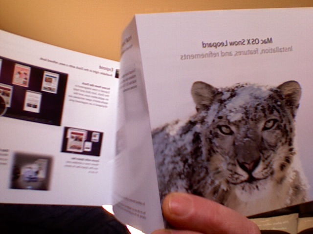

What color are the snow leopard disks you are trying to use? Do you have a photo of them?
[/ATTACH] I have tried to attach 3 pictures box, disc, instructions leaflet for snow leopard, if this hasn't worked the disc is basically a white colour.
