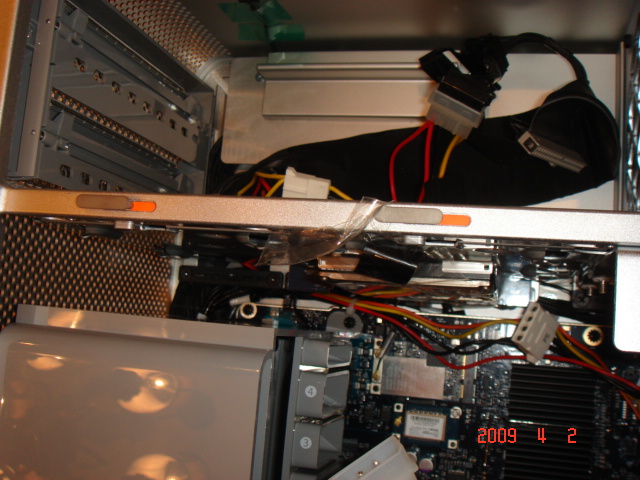

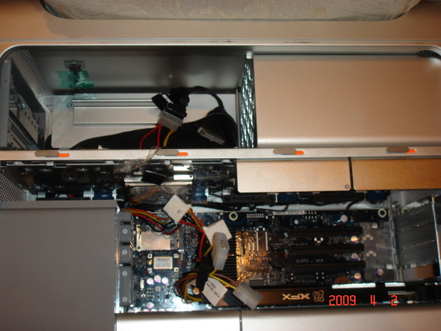

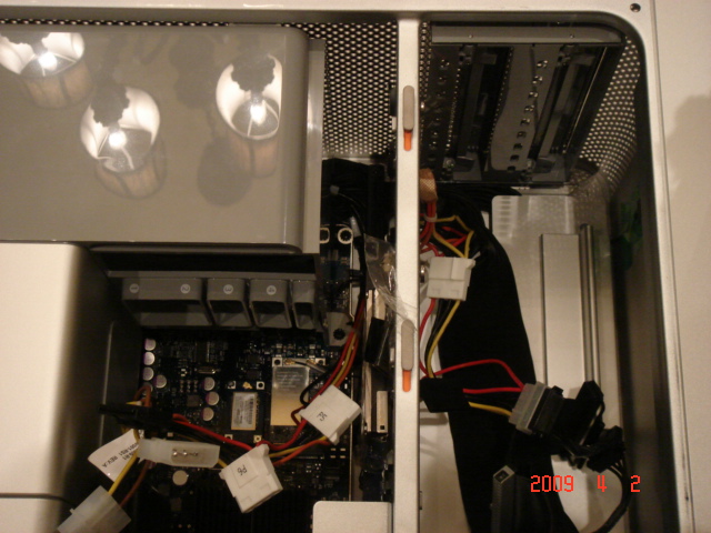

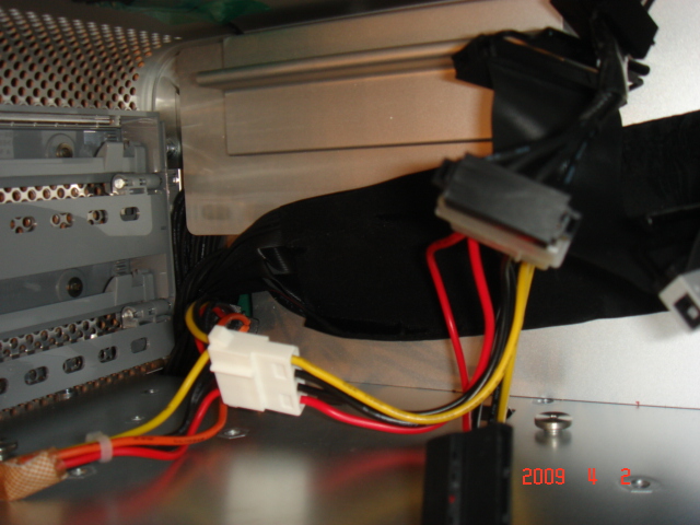

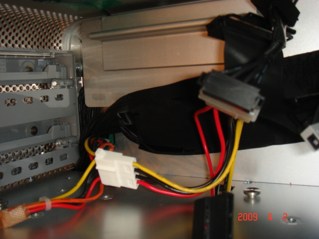

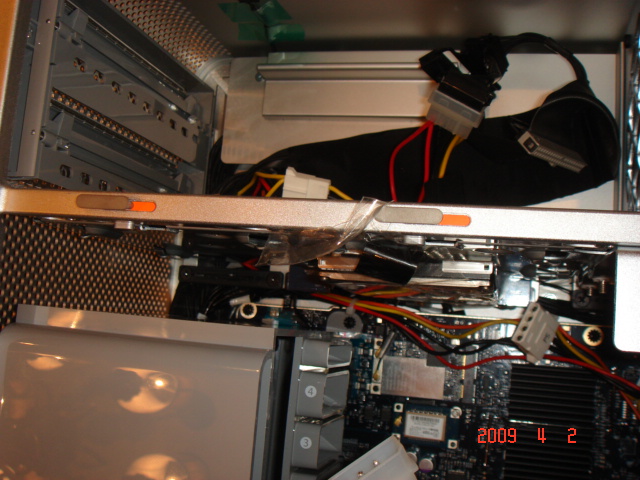

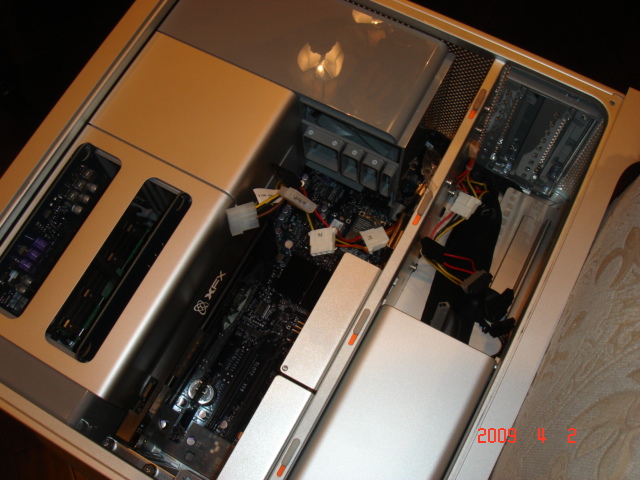

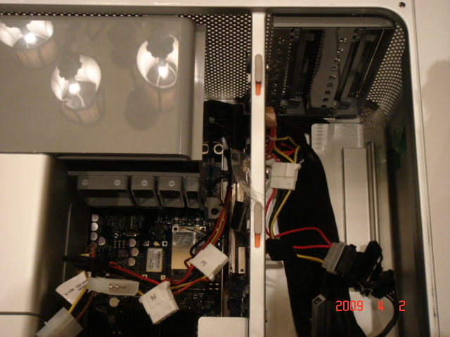

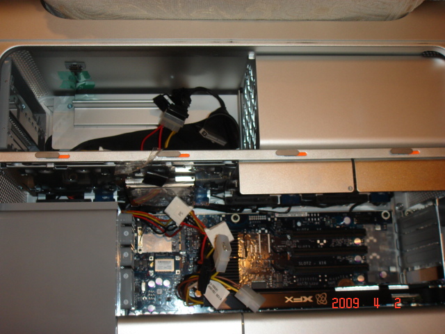

ALL these cable were cut from my old PC power Supple..
Just use your Dvd rom's power cable if you got your 2008 mac pro which the Dvd rom still HDD not SATA so there is a 4 pin power adpater but one thing you should DO IT YOURSELF I will SHOW some photos
You should cut off and have 4 cable which will put into the 4 pin connecter (see photo)
And I let all cable go thru the conner of the case which take the first HDD away and you will find way to get thru it some more pics.
Cheer By the I DIY my XFX Nvidia 8800 GT 256MB ,I am thinking upgrade to
ATI 4870 but this need 2 6pin much more power supply anyone has try it??? Does the Mac pro power can support???and How much the MAX Watte of standed power supply...Thanks
