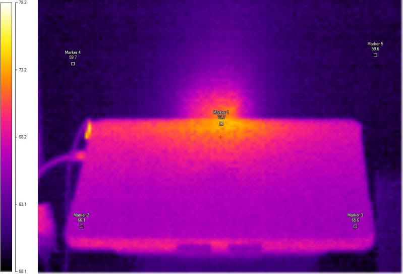

Edited to clear up the picture, see more pics in post 23
Hopefully this will end a few of the heat threads
photoshop, indesign, safari, itunes, and maybe 1 more program running.
This clearly shows the majority of heat is created and radiates from the top left corner (CPU is located there), and vents from the hinge below the display (you can see the heat rising on the display).
Measurements are Fahrenheit.
Please ignore me in the screen :D
Photo taken with Fluke Ti20 thermal imager.
This clearly shows where the heat is created.
Actually, it doesn't. That only shows heat that is radiated after the primary heat has been vented away via the fans through the vents in the rear of the MBP, by the hinge. There is no venting at all through the keyboard, as there is a solid sheet under the keyboard, preventing airflow. Heat radiates in all directions, including through the base, but that doesn't make those areas a vent. The two primary heat sources are the CPU and GPU.

I agree, but then I see threads titled "why do my fingers hurt near the escape key" and "where are the vents" and "how does heat escape" etc...
the hinge is the main vent. I will have to change the span, level and emissivity settings to show the heat escaping to the outside, but that will have to wait until tomorrow.

Sorry about the confusion everyone, I could have worded the title more clearly.
I did not mean to say the keyboard was a vent, the picture is just showing radiant heat on the bottom panel of the computer. If you look at the base of the screen you can see heat rising up the screen from the hinge, this is the vent. I had the camera focused on the main SOURCE of where heat is generated.
I'll try to get some better pics of the escaping heat today.

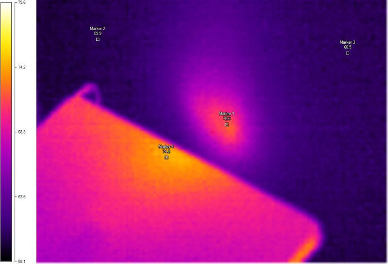

ok, here are some more pics taken while ripping a DVD using handbrake
This shows less focus on radiant heat and more on the vented heat at the hinge.
Here is a top view in clamshell mode (note the heat on the wall behind the mac)
And a bottom picture in clamshell

Exactly! And Apple wouldn't give instructions on operating in clamshell mode, but all these facts seem to elude many people. Well done on the most recent pics, by the way! How do you change the focus from radiated heat to vented heat?
