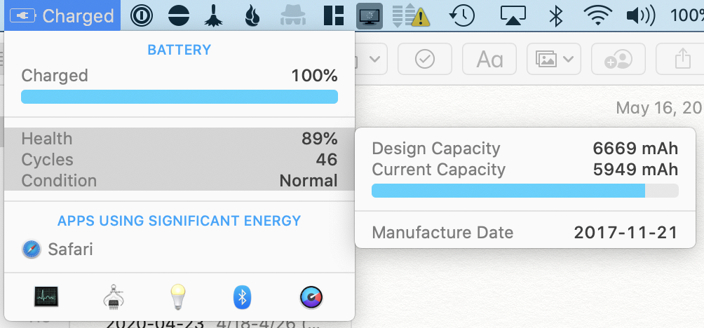

I thought this might be a swollen battery issue. I pulled up iStatMenus to look at the battery health, and you can see that it's at 89% health, with only 46 charge cycles. The battery is only about 2.5 years old.

Is this typical? I'd appreciate hearing from anyone else who's experienced this or has any useful advice on next steps. Thanks!

If the battery is swollen, and it sounds like it is, you need to have it replaced- swollen batteries are unsafe. Swollen batteries also may not show as a defect in any of the system monitoring utilities such as what you’re showing above.
A battery may swell up for more reasons than battery cycles and use. In any case, that is far too risky to have it not taken care of. Please take it to Apple asap and get it looked at.

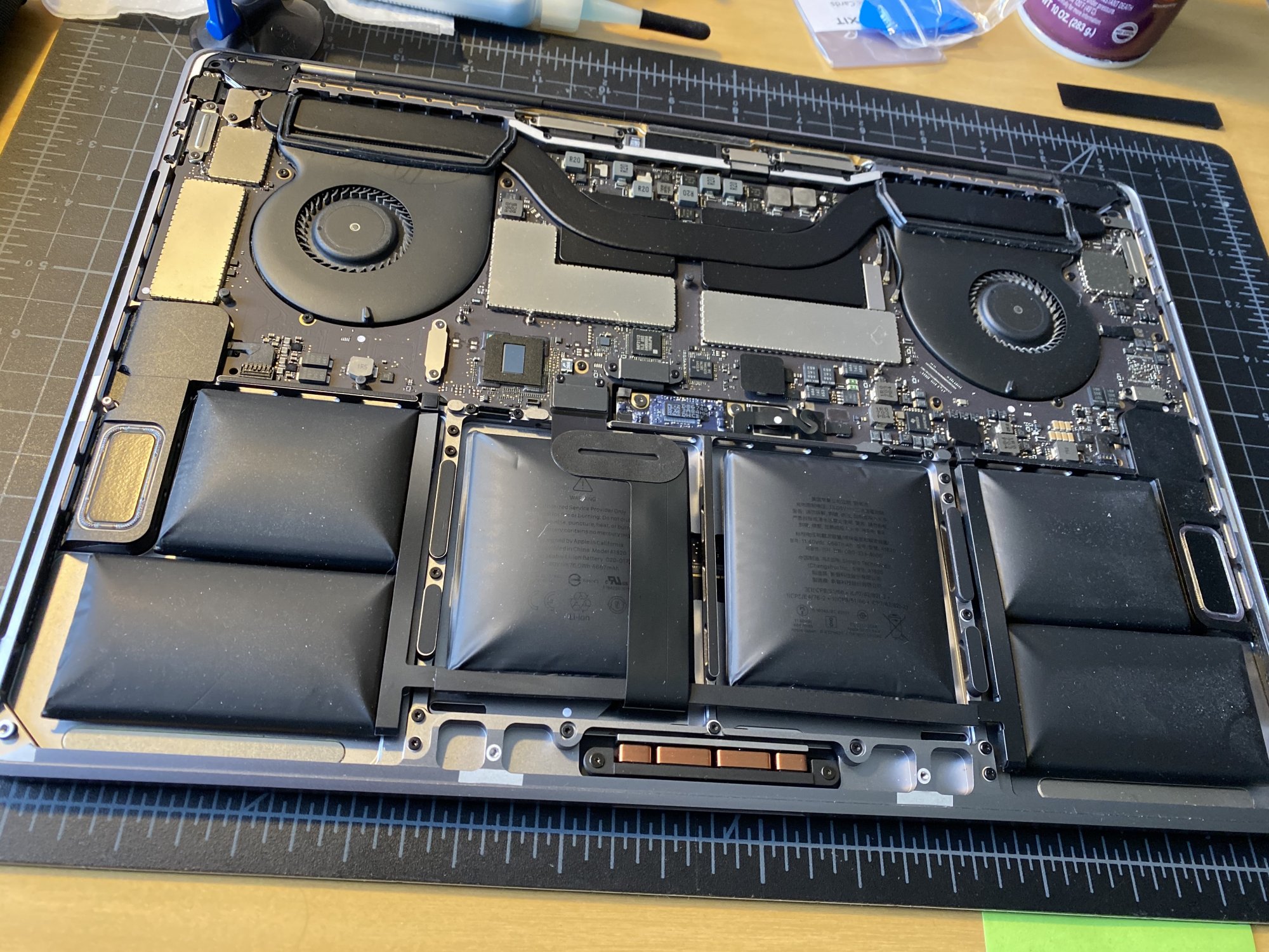

So yup, as it turns out: The battery was in very bad shape. I don't have any clear idea on what caused it, but my best guess is overheating. This is the first time I've seen this, in any device I've owned, so it was a bit of a mystery and adventure to figure out what was happening and to get it fixed.
If you're mechanically/technically inclined and like to do your own repairs—and, big caveats: if you have done stuff like this before, and you are patient, and you know a bit about what you're doing—I'd recommend the battery replacement kit from iFixit and following the guide there. (I posted some of my "story" there with more details and pictures in case you're interested.) Repair took about 3 hours total, and it was not easy. Discharged the old battery and recycled it with a local electronics recycler.
I hope in the next generation of MacBook Pros, Apple at least tries to make these machines more serviceable, because this was a huge amount of effort to replace this theoretically-consumable part. My work laptop takes less than 5 minutes to swap out the battery. I appreciate Jony Ive's "beautiful even under the hood" design sensibilities, but that ethos comes from a design studio where budget and reparability are not priorities.
