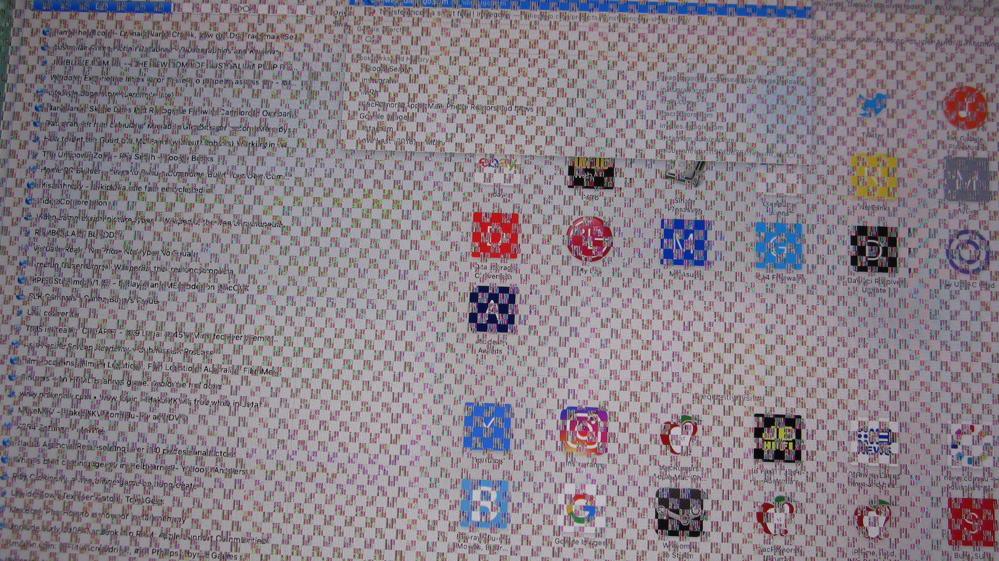

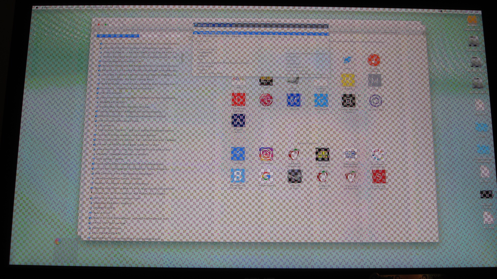

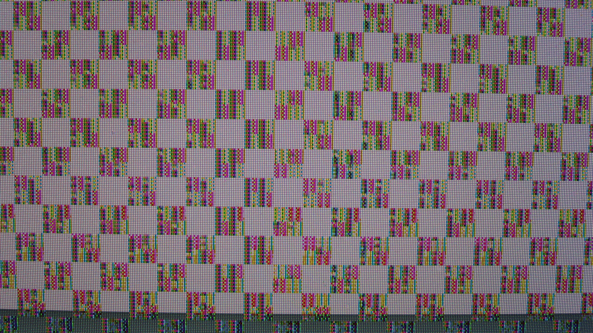

Here are some photos of what is happening. It's been happening since I upgraded to Mojave, and I think before but I can't remember.

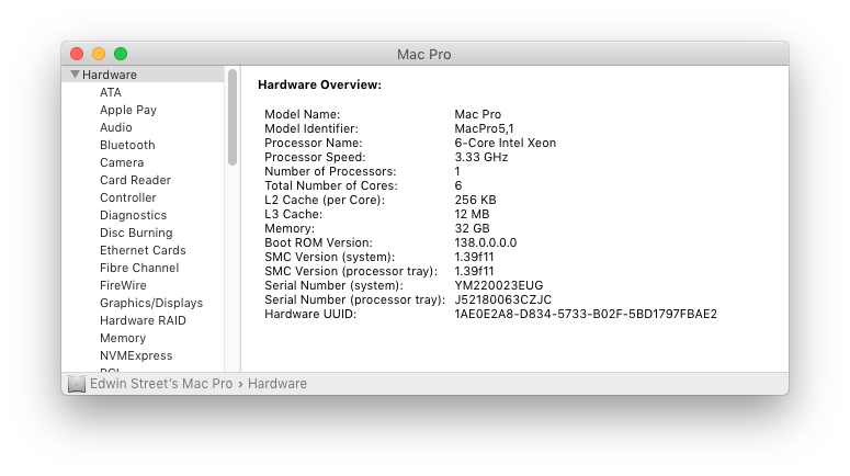

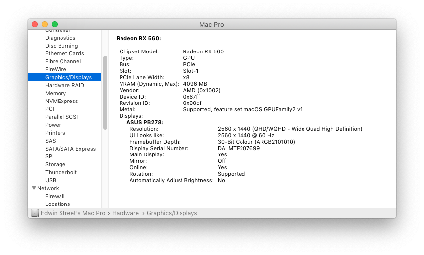

I've also added some screenshots of my specs.
Graphics card is a Gigabyte.
I have a 1TB SSD sitting on an Apricorn Velocity Solo x2.
It happens randomly about once or twice a day. The screen goes all pixelated and I'm forced to hold the power switch until it shuts down.

Your, firmware is behind too. 10.14.1 comes with firmware 140.0.0.0.0. I recommend you download the full Mojave Installer package and initialize the install so that it will update the firmware. You don’t have to go through the full install process (although it wouldn’t hurt).

This is the perfect example of VRAM corruption, did you bought your GPU new?
Cards used for mining usually have the VRAM overclocked, if it's a used one flash the original firmware and test it again.
I had a similar problem a few years ago and it was my graphics card that was broken: the pixelated screen and blocks are very symptomatic of it. If you have another graphics card to slot in and compare that will help you isolate if its the problem. Hopefully yours is still under warranty since it's so new.
Thanks so much for your help. I haven't got another graphics card or monitor to test but going off what you've said I'm pretty sure it's the graphics card. I'm desperately looking around for my receipt to see if it's still under warranty.
Also, I successfully updated my firmware to 140.0.0.0.0. I had to download the full installer from the Mac App Store to do it instead of just the update.
