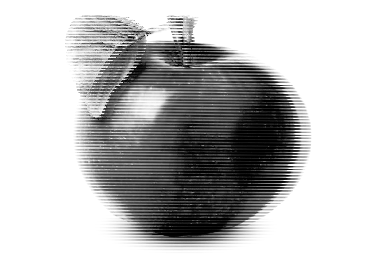

okay so if its so simple would you please try recreating it on any picture ? id really like to see how this would turn out with just a few easy uncomplicated photoshop layers which is what you are suggesting .
here is an image
if you can show me how u would make this image look like the image i posted id appreciate it thanks

1 minute in Photoshop. Draw some lines in illustrator. Drag them in float selection and float layer move around and play. You need to be able to use PH to do this effect. If you want distorion as well. get effect right thin use the warp tool.
Didn't realise you wanted it animated...if this is the case. Then its an after effects job would be easier than hand animating a loop.
I never volunteered to do it for you, but I will offer some explanation. The important thing is that you stop trying to view it a single package. Bring it into something like preview or photoshop where you can view individual frames. If it can done with filters I'd guess a polar coordinate version of a radial blur and some distorts. You may have to layer them. If you have to do that by hand it will take much longer cutting it into strips. The vertical offset can actually be done with the filter offset. You may have to mask this in on parts, as you can see the image is not always affected in its entirety. If you just view this as a black box where it's all one thing rather than a built up approach of different elements, you'll never understand it. After Effects as mentioned might have a filter. They often exist for this kind of stuff. They package various actions just like you would with a script. It offers less control than doing something by hand, but obviously it doesn't take very long if you need to replicate it.
Anyway I'm saying something probably exists as a plugin, but if you want to do it by hand, you'd need to address each thing separately. The vertical scan motion is completely different from the wavy distortion. The black bars that darken in parts are another thing. Don't try to make them into a single action if you're doing it by hand (I emphasize if). Just handle them one by one. It's not very long, so I'm not sure I'd even bother with keyframing here.
