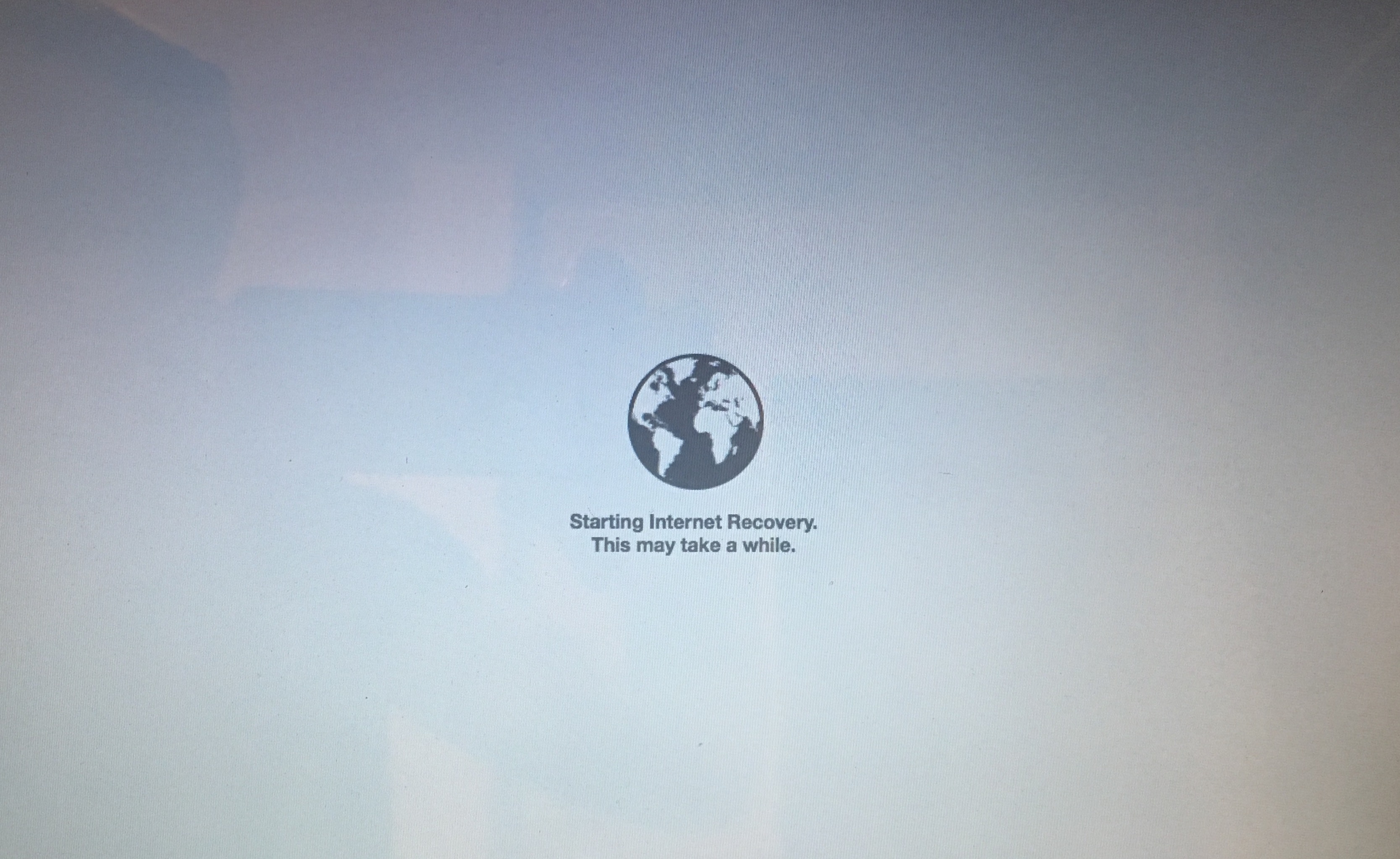

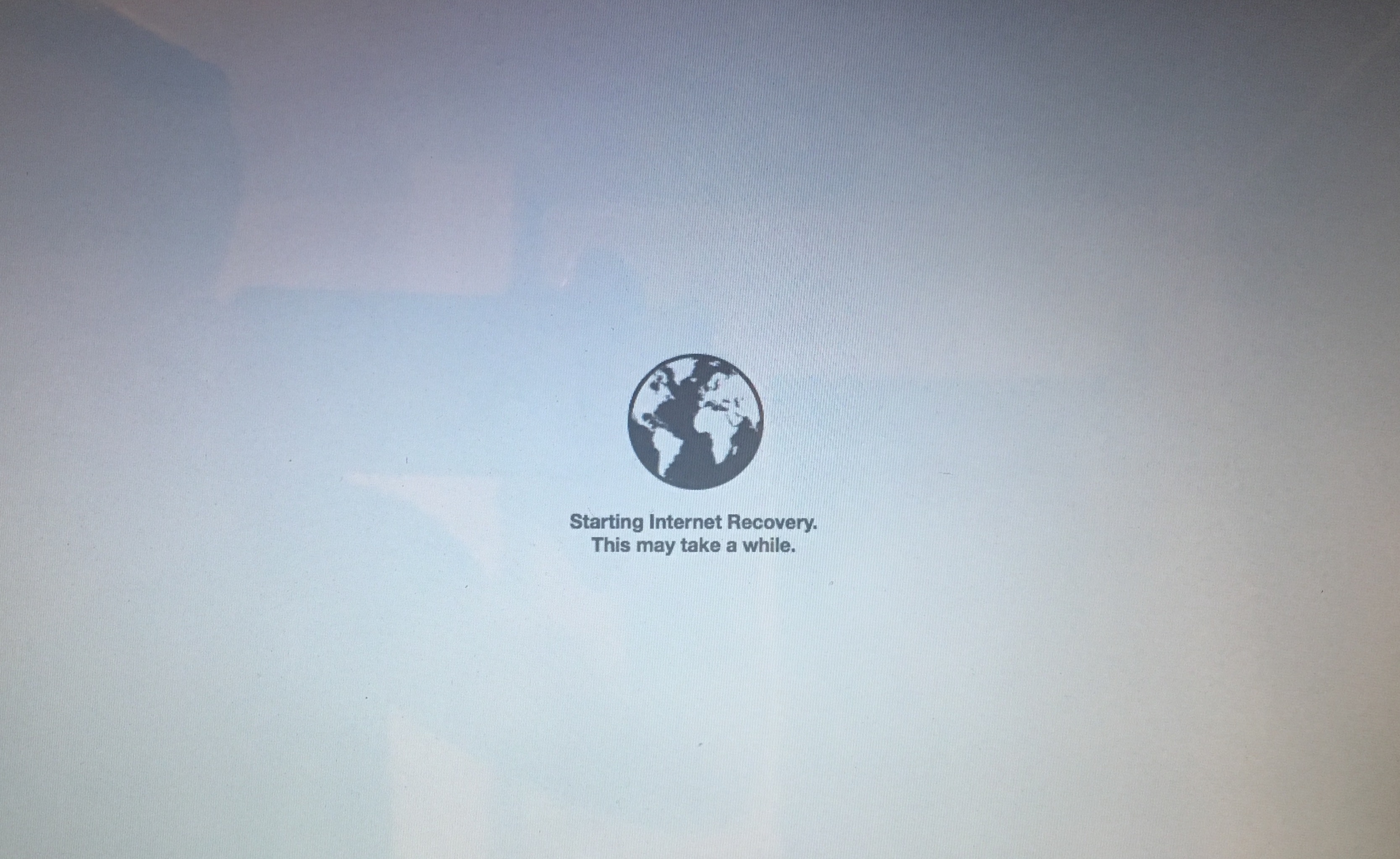

So you get the spinning globe when you start Internet recovery, followed by the recovery screen?
To the NEW hard drive? Is this a known good enclosure?
Yes I do recall that and it started downloading El Captain and then would fail.

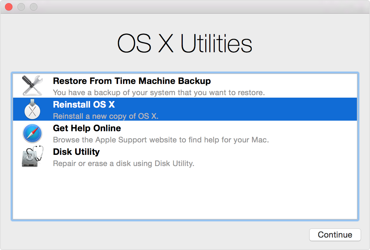

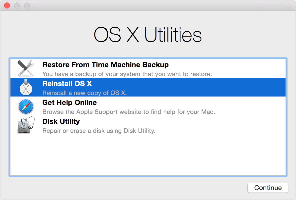

Okay... so once you see the spinning globe after a bit your should see this recovery screen. Then from their use Disk Utility to format the drive to Mac OS Extended (Journaled). Then quit Disk Util and click reinstall OS. That will download the OS version that came from the factory (I think Lion and for sure not El Capitan).
Are you getting the recovery screen like this after the globe?

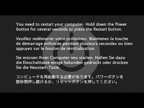

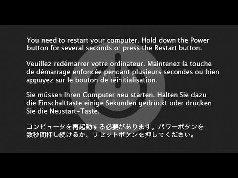

Tried restoring time machine backup I made with new computer to my MacBook. Came back to the screen that said
