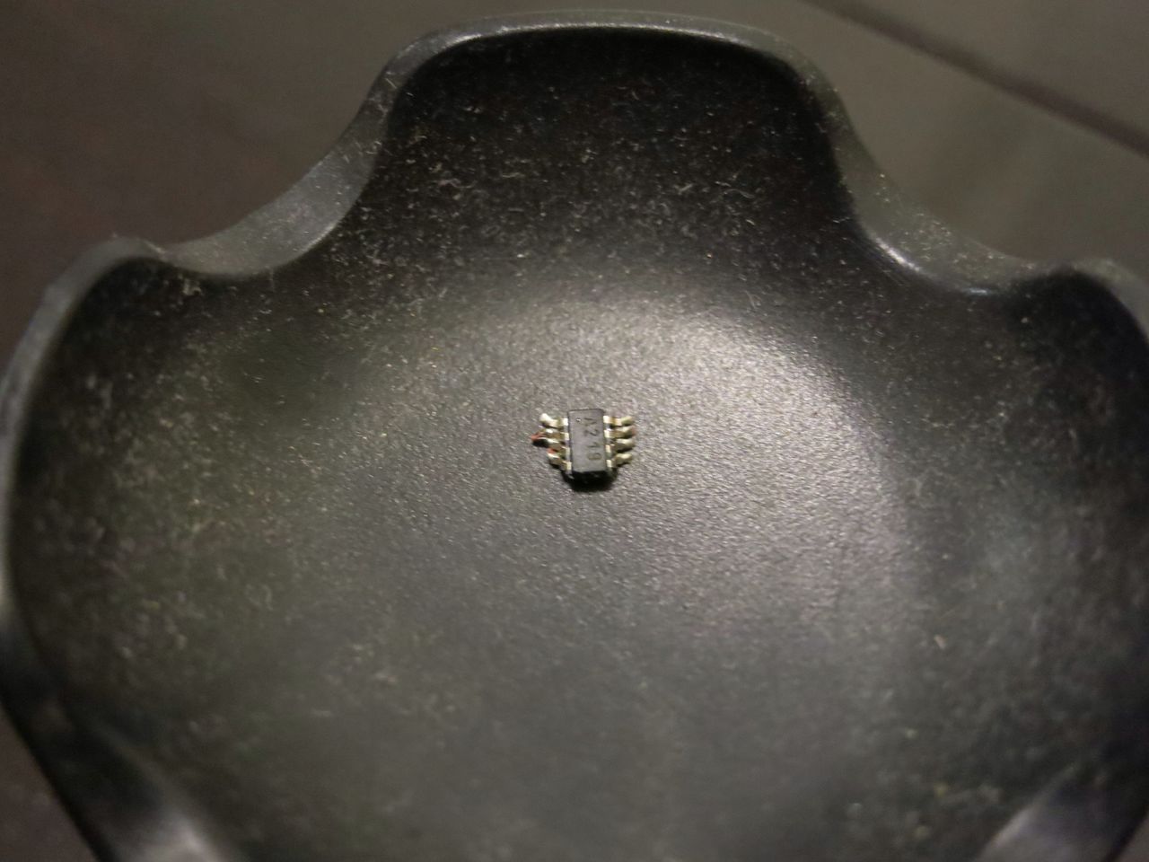

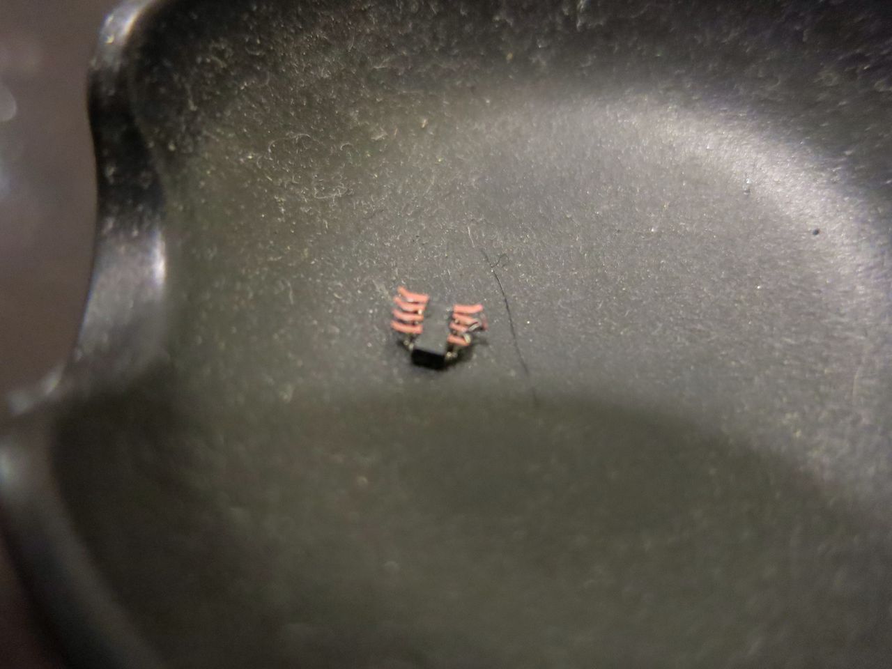

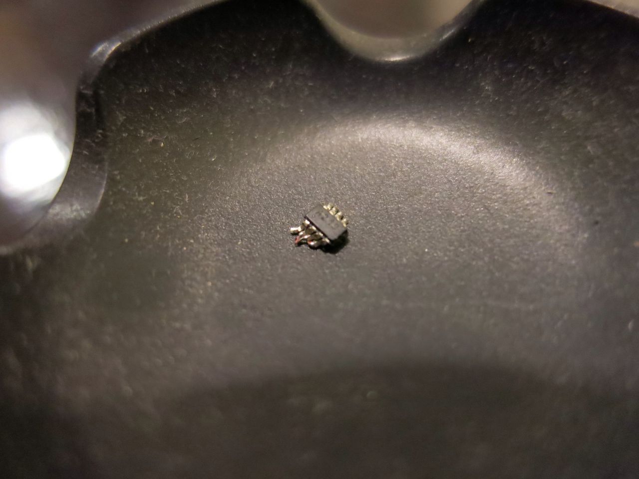

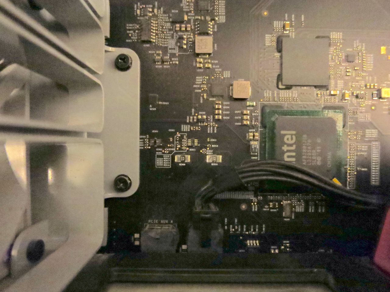

    I was trying to unplug the pcie gpu cable from the back plane and It was kinda stuck (I didn't press hard enough the release tab) so when I was able to actually pull it out a little chip (VE001) that it's immediately above the plug just flew out of my back plane.
    I tough for sure my Mac will not turn on or that once it turns on it will start smoking, to my surspire it did turn on and runs like normal
    So I'm wondering what should I do
    Just let it be
    Or try to glue it back (soldering it)
    Or what you guys think
    What's that little chip for?
    I have a dmg image of the asd for my mid 2012 but it seems that it's missing the Efi dmg image so I can't boot to diagnose my Mac. Do you have a copy?
    I'm planning to install a second gpu r9 280x
    So I wonder if I should stop that?

    It's a voltage controller.
    MP will run normally as long as you won't connect power cable to 1st connector. If you'll do that, computer won't start. So ask yourself if it needs to be fitted back into place or not ;)
    BTW, you broke solder pads off of the board.

    I had the wire plugged in the first port and It worked fine I moved it to the second one to take the picture

    But was it connected to the card? One which I bought damaged in a such way, didn't want to start when GPU was feeded from the connector with missing regulator.

    Very hard to fix. As long as part of trace can be located it may be possible. Sometimes they stop on top level and a little rivet looking spot takes the connection to a lower layer of PCB, if there is no metal to connect to then it is not fixable.
    Probably easier to get a 2nd PSU for GPUs that fits in optical bay.

    I don't think 99.9% of the world should or could attempt to fix that SOIC-8 chip
    I am only well versed in that repair as a result of replacing a few thousand EEPROM chips which are identical. I have lifted a few traces in my time and know that repair is NOT for a beginner at all

    Do they know you've pulled up all 8 pads?
    Not trifling work.
