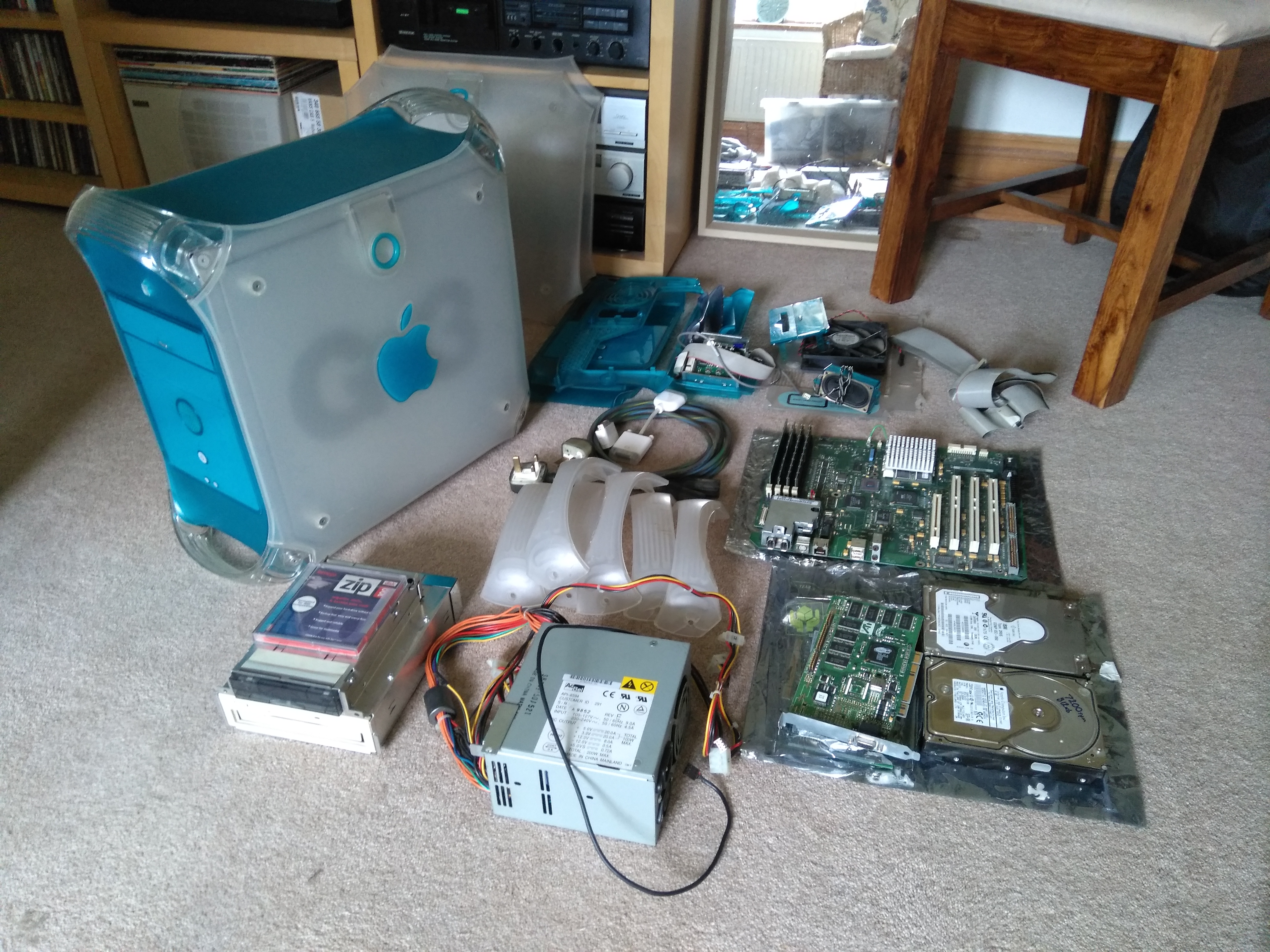

[doublepost=1560095975][/doublepost]Picture, just cuz why not?

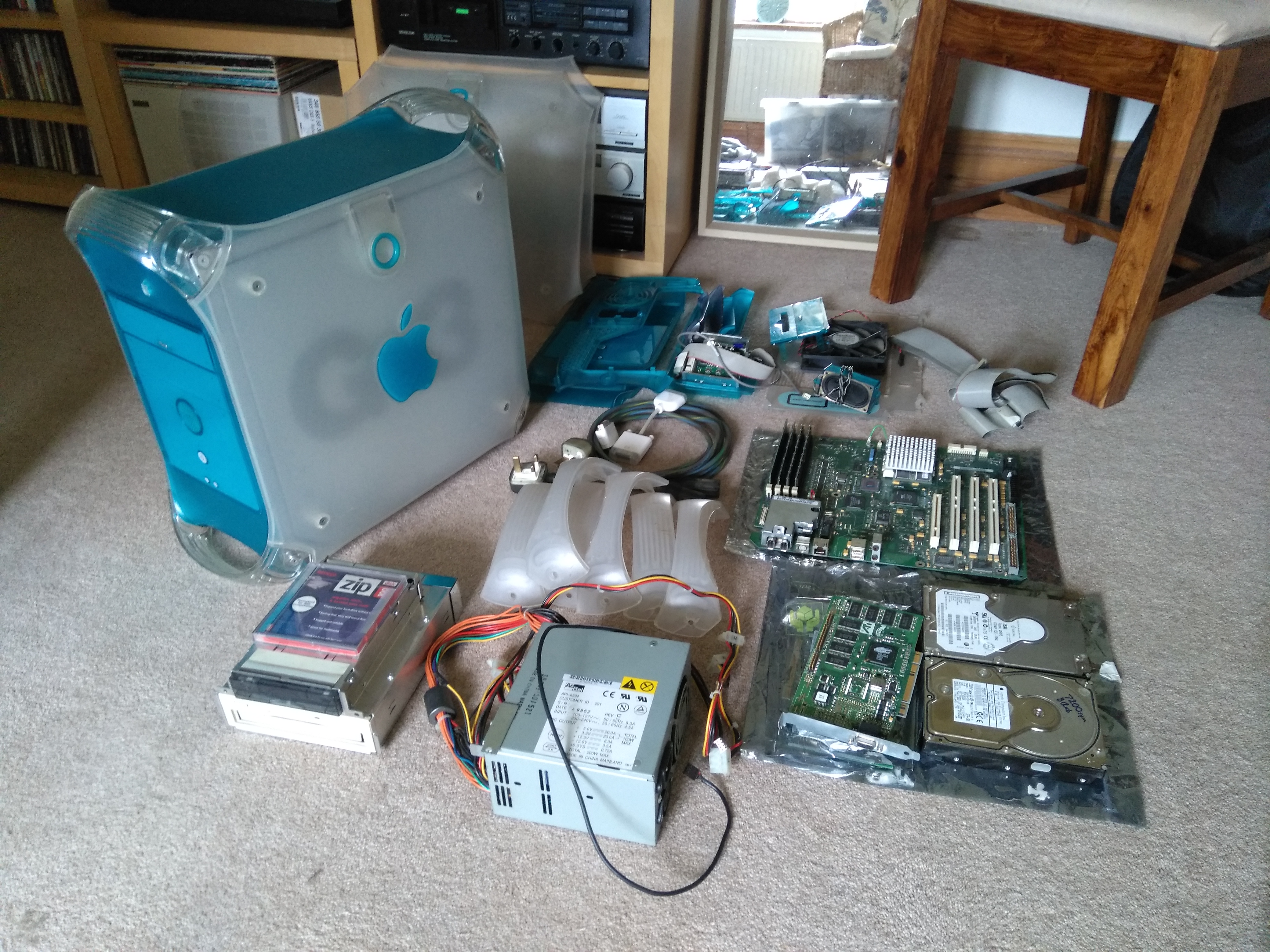

[doublepost=1560095975][/doublepost]Picture, just cuz why not?View attachment 841952
