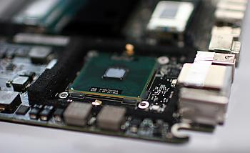

Houston we have a problem. I did alittle more studying. The current chip in the Mac Mini is a Micro-FCBGA while the quad core Q9100 is a Micro-FCPGA. This means the Q9100 is better suited for a socket, and the P8400 is not for a socket at all. Basically what I learned is that the Mac Mini CPU is NOT SOLDERED in!!!!! IT'S EPOXIED IN PLACE!!! Micro-FCBGA means micro flip chip BALL grid array. Micro-FCPGA means micro flip chip PIN grid array. With Micro-FCBGA the CPU rests on contacts and is glued in place. So if you can figure out how to remove the epoxy without destroying the logic board, then you can replace the Mini's CPU with another Micro-FCBGA type CPU. I'll get back to you guys when I learn more.

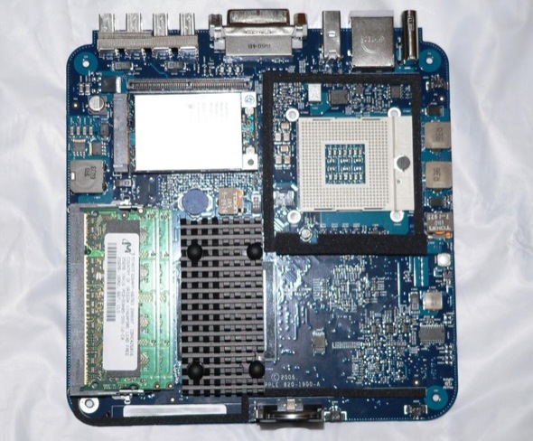

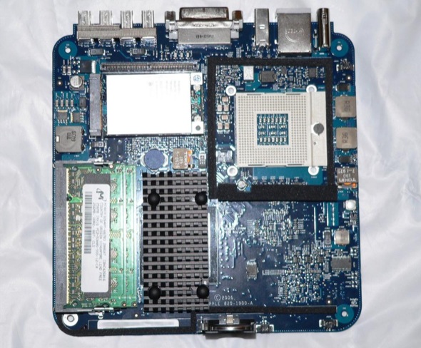

Ok, I back. Someone posted a picture of the old Mac Mini logic board with e socket. This great because if someone has a bunch of blown logic boards I could theoretically get the socket off one of those and use it on the new board, then throw in the Q9100 and boom baby. 😀
