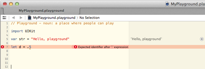

You're not making sense?
Why doesn't this compile?

I think maybe Apple should've picked a different character to denote enums maybe # or > rather than . for enums... Either way 0 is implied and should be implied always in the case of .5. not being able to assign .5 to a variable is confusing IMO.
I don't think it's confusing it as an Enum though as that enum syntax only works on variables that have already been established as a member of an enum type.
Creating the static it's typeless until it can infer a type and can't infer a type from .5 Which it doesn't infer as a number as all numbers start with a number character.
I think the point is in Swift anything that starts with a punctuation character is an operator of some kind. Which is kind of neat in that it allows user defined operators constructed from a group of punctuation characters

Both of those will fail because the constant 5 is not assignable (not an lvalue). Only mutable values (lvalues) can have the ++operator operate on them. Constants are necessarily immutable rvalues.

It will fail in C, C++, Java, JavaScript, or any other language I know of that has a ++ operator that means "increment".
The left side is let d. It's on the left side of the assignment operator =. The right side is 5++. In order to assign a value, the right side must be evaluated, otherwise there's no value that can be assigned. Since 5 is not an lvalue in and of itself, the expression 5++ is invalid, because ++ and -- can only operate on lvalues.
An rvalue is effectively constant (unchangeable), so it's logically impossible to change it. If it were logically possible to change it, then it would be classified as an lvalue, not an rvalue.
