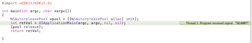

help please!
THANKS!
SIGABRT means you've tried to access an invalid pointer somewhere in your program. This is one of the hardest things to diagnose through a forum because the scope of the error is so large.
Start by switching to the LLDB debugger. In my experience, the LLDB debugger is more likely to stop at the line where the invalid access happens than GDB will.
To change to the LLDB debugger (assuming your using XCode 4.x).
1. Click the left-hand side of scheme popup menu in the toolbar.
2. Edit Scheme...
3. Under the Info tab, changed debugger from GDB to LLDB.
Rerun the program. Where does it now stop?

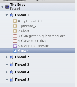

this is what i get now:
Do you see the dashed line between the two stack frames? This dashed line represents hidden stack frames.
You'll see a slider at the bottom of the thread view pane. Slide it to the left (I think) until you see the full stack trace; that is, until you don't see a dashed line between two stack frames.

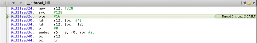

ok i did it.
here it is:
what now?
PS: thanks for the help!!!
I don't know. The stack trace doesn't give me any clues. It is weird though that before the bottom of the stack trace was std::terminate and now it's not. Are you using any C++ code in your project?
I would perhaps put a breakpoint in your app delegate's application:didFinishLaunchingWithOptions: and see if it hits it. If it does hit it, step through and see what happens.

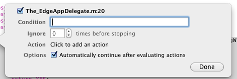

this is going to sound stupid, but how to i create a breakpoint?
do i just press the button next to the line?

What do i fill in for the condition, ignore, and action?
