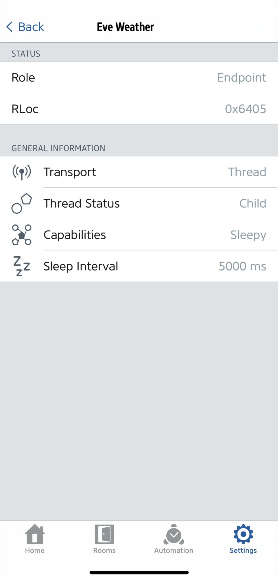

I got my first thread device, the Eve Weather. My new Apple TV (with thread) was acting as the hub when I set it up, and set up went very smoothly. You can check the thread status using the Eve app, so I could see as it initially connected via Bluetooth and then thread must have become activated, as it quickly changed to a thread endpoint. It’s been rock solid since, even though the device is half way down my garden.

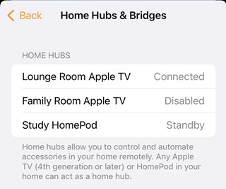

I then restarted my new Apple TV, which caused the hub to swap to my old Apple TV (no thread). This did not affect the thread connection at all - with the Eve Weather remaining connected via thread no problem. I guess this answers the question of if the active hub must be thread - it doesn’t (as long as one of your hubs is a thread border router).
Wonderful! Thanks so much for confirming that 🙂

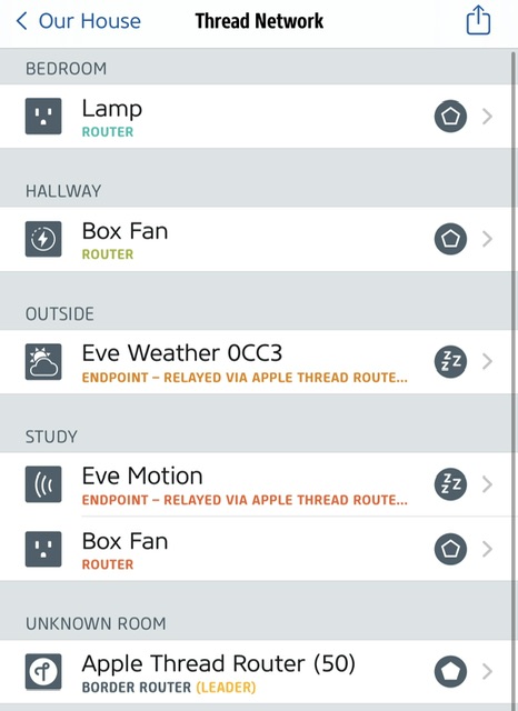

There are a few things you could try, that I’ve found useful for similar problem solving.
First, I would do a hard reset of the HomePod mini (not using the home app - rather the plugging out and holding the top, etc., method). All the recent updates confused a few of my HomePod minis and I needed to do this. Don’t forget to delete the mini from the home app after. Then set it up and leave it alone for a while to configure (say a couple of hours).
Now, make sure you’re using the latest HomePod update.
Make sure all your Eve devices are updated to the latest firmware and you’re using the latest app version.
To rule out ‘interference’. Plug the Eve energy (which also works as a thread router) in as close to the HomePod mini as possible. Use the Eve app to check the status of thread. Go in and out of the tread status section a few times to see if things update from Bluetooth to thread. In can take a few minutes.
Now turn off the Eve Weather and turn in back on in the same room as the HomePod mini and the Eve energy.
It should look like the screen grab:
If this gets thread working. You should now be able to move those devices further away and maintain thread.
If not, try resetting the Eve devices first, and setting them up again in the HomePod mini room.
If that doesn’t work, I’ll try think of something else 🤔

It’s sounds to me, as none of your devices have ‘activated’ the thread border router function in your HomePod Mini, that the problem may well lie there (or surely at least one of the devices would be on thread).
The hardware reset has worked well for me solving problems (when all else has failed). Also, matter was only introduced to HomePod Mini in homeOS 16.1, so definitely worth checking you’ve got at least that.

Thanks mate, yep that did the trick.
The HomePod mini was already 16.3.2 so I re-enabled one of the Apple TV 4K 2017’s to keep the Home online, went for the HomePod hard reset (power cycle, hold down, spinning red etc) and lo and behold a thread is active without the HomePod mini even needing to become the Connected hub. Thanks! 🙂
