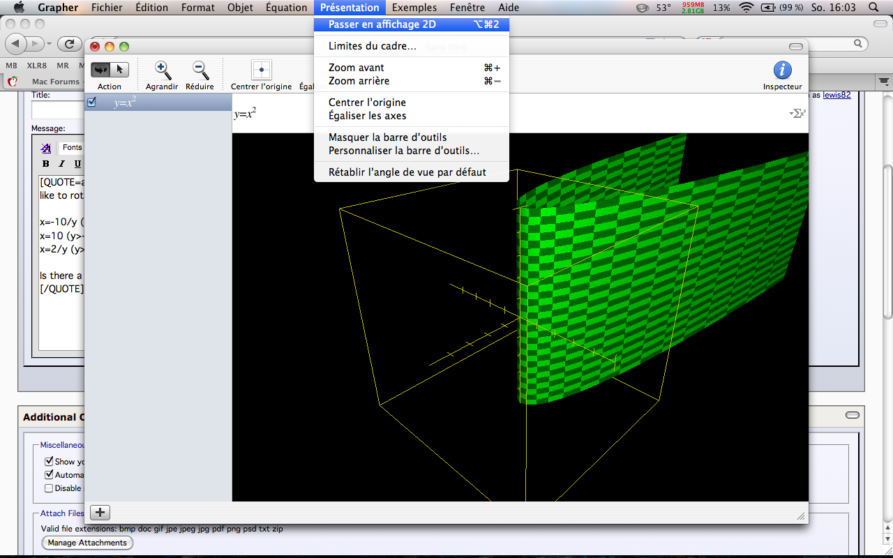

Go in this menu option. I don't know what it is in english but it should be at the same spot. It toggles the 2D/3D render modes.

Right, I can view it in 3D, but the issue I'm having is actually rotating it about the y-axis, so that it creates a sort of chiseled-out cylinder.
In that case just create a 3D equation, using Z=as the function, and X as the variable.
It should work. 😉 (At least it did with my y=x^2 vs z=x^2 example)
