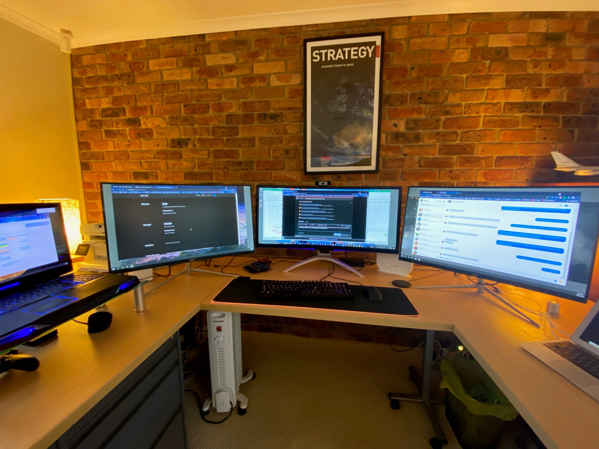

I'm looking at purchasing the Intel 3.2Ghz (6 core) Mac Mini with 32GB RAM and a 1 TB SSD to replace an old Alienware desktop. I have three displays with the PC - a 35" Ultrawide, and two 32" Displays (see pic) and I need the Mac Mini to run all three as an extended desktop. Apple says that the intel Mac Mini will run up to three displays - two at 4096 by 2304 at 60 Hz on Thunderbolt 3 via adapters, and one at 4096 by 2160 at 60 hz via HDMI 2.0. Can anyone confirm that this is as an extended desktop - not simply a mirrored display? I'd hate to spend all this money (about $3400 AUD) on a new computer only to find its not as capable as my ten year old Alienware.
