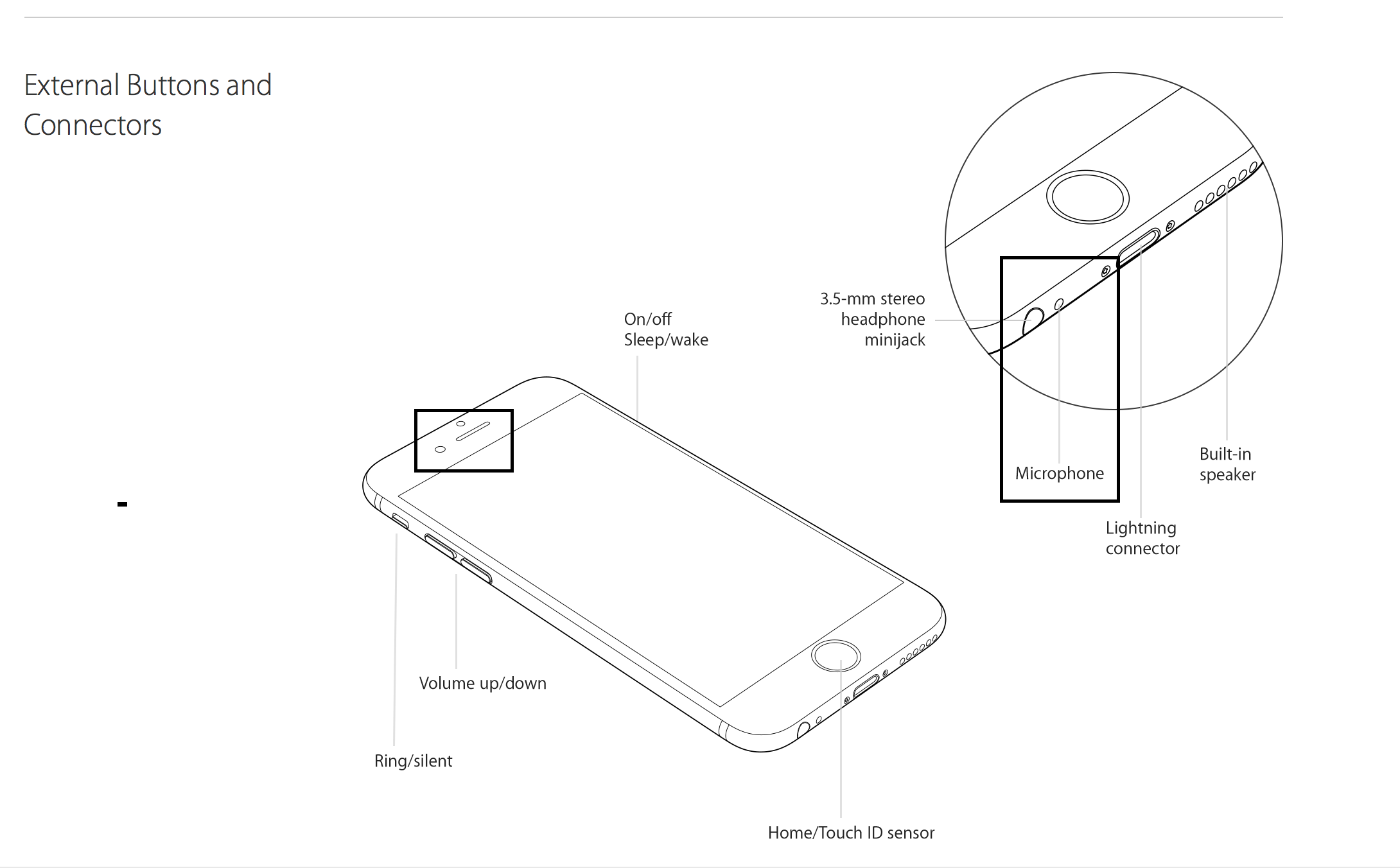

The 6 plus has 3 microphones just like the 5 and 4.
😕I would like to know which microphone is active with which app?😕
Some cases seem to cover a microphone.
As above there is 2
iPhone 4/4s was on top next to headphone jack and at the bottom.
5/5s was between camera/flash and bottom
6/6+ same as 5/5s
Shown below

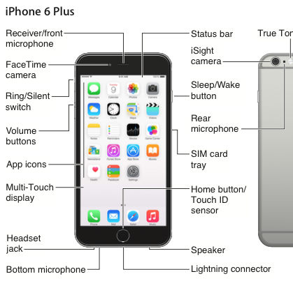

3? There's one the bottom and the one next to the camera. Where's the third?
The user manual lists them as front, bottom and rear.
See attachment. However, the manual does not tell which works when?
