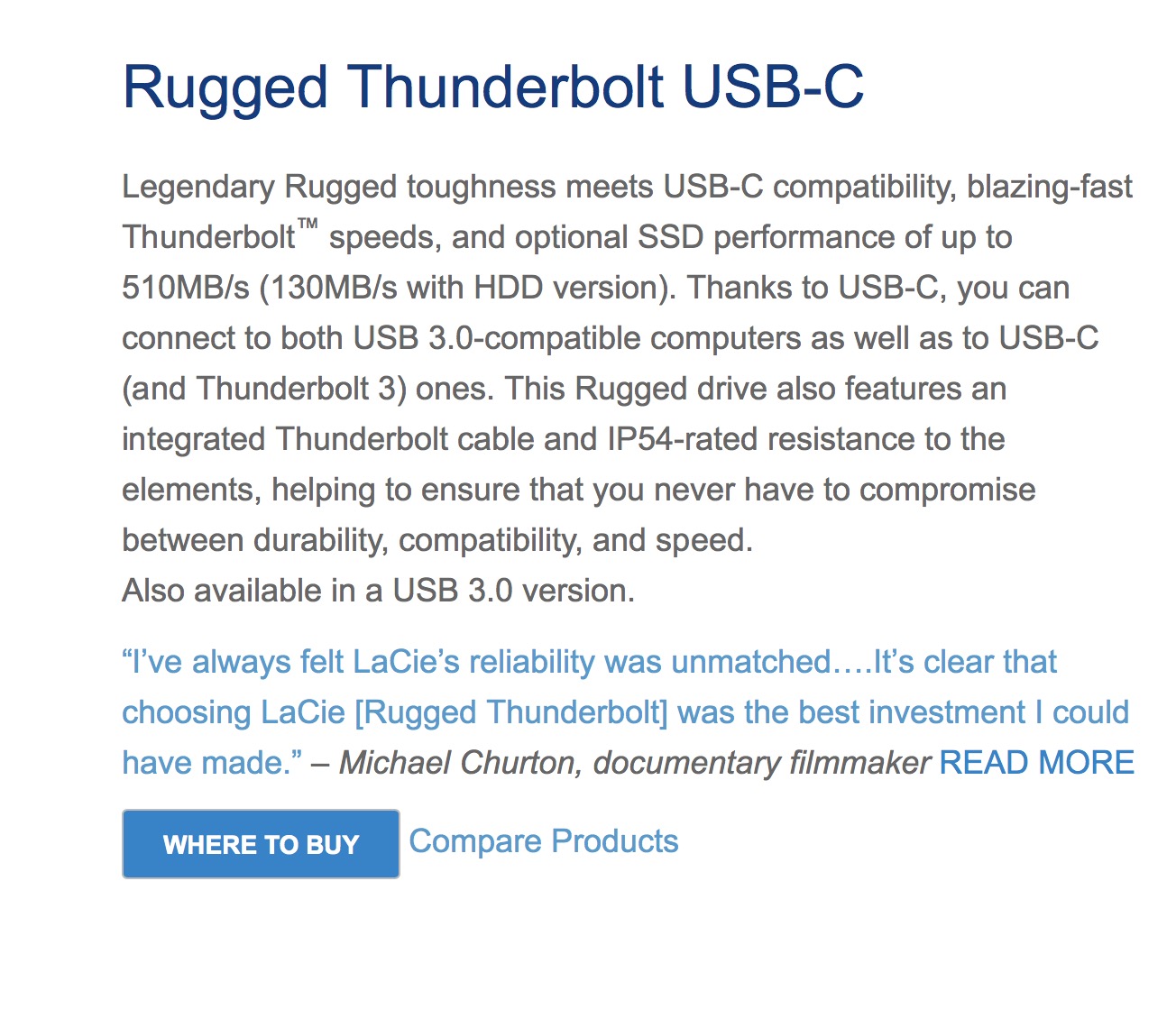

ok i found this:
but i dont understand if it will work in usb mode or t3 mode. in fact what it depends on? cable or what?? an official T3 ssd like sonnentech fusion drive its t3, but once i connect it with a standard usb-c cable it will be reconized as usb?? its so confusing...

ok i found this:
Yeah it is confusing.
So the Lacie screenshot you attached "appears" to be Thunderbolt 1 and USB-C. Very misleading marketing.
How TB3 works is that it has nearly all the protocols available in a single cable/port. What this means is that if a cable/port fits, it'll work no matter what by negotiating the protocol. So if you plug a USB-C peripheral into a TB3 port, the peripheral will work, but will operate as USB.
If you plug a TB3 peripheral into a USB-C port, I don't think it'll work.
