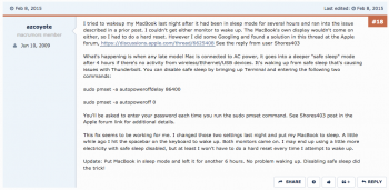

I hope I didn't come off as a jerk. I was trying to be understanding and civil. Most reviews of any dock talk about this problem. Biggest thing that puzzles me, is how it will wake after, sayyyyy, five hours, but not after 6 or 7.
If anyone has answers, or can help me understand the issue. I'd be glad to know.
Gonna try this...
