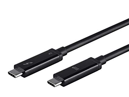

Also more a general question with USB and Thunderbolt 3 now having the same plugs who am I supposed to hold them apart and know what cable is what and if the devices are USB c or Thunderbolt 3?

How do you tell thunderbolt 2 cables and sockets from mini displayport ones? Thunderbolt devices and cables have the thunderbolt logo on them. If there's no logo, assume it is USB c only. Your bigger worry should be whether USBC cables are USB3.2 Gen 2, USB 3.2 Gen 1 or just USB 2...

need 4 ports, have bought a Thunderbolt 2 to Thunderbolt 3 adapter but wasn't sure if I can daisy Chain them. A noticed now the flash on the Thunderbolt 3 cables thanks for the tip.
How can you determine between different USB C cables?
As standard practice with USB in general. Have to look at the small icons next to the port or on the cables. Thunderbolt 'lightning' icon means TB. The myriad of other cryptic USB icons of the year means something else.

TB 3 has a TB icon on the connector portion. USB-C doesn't .
