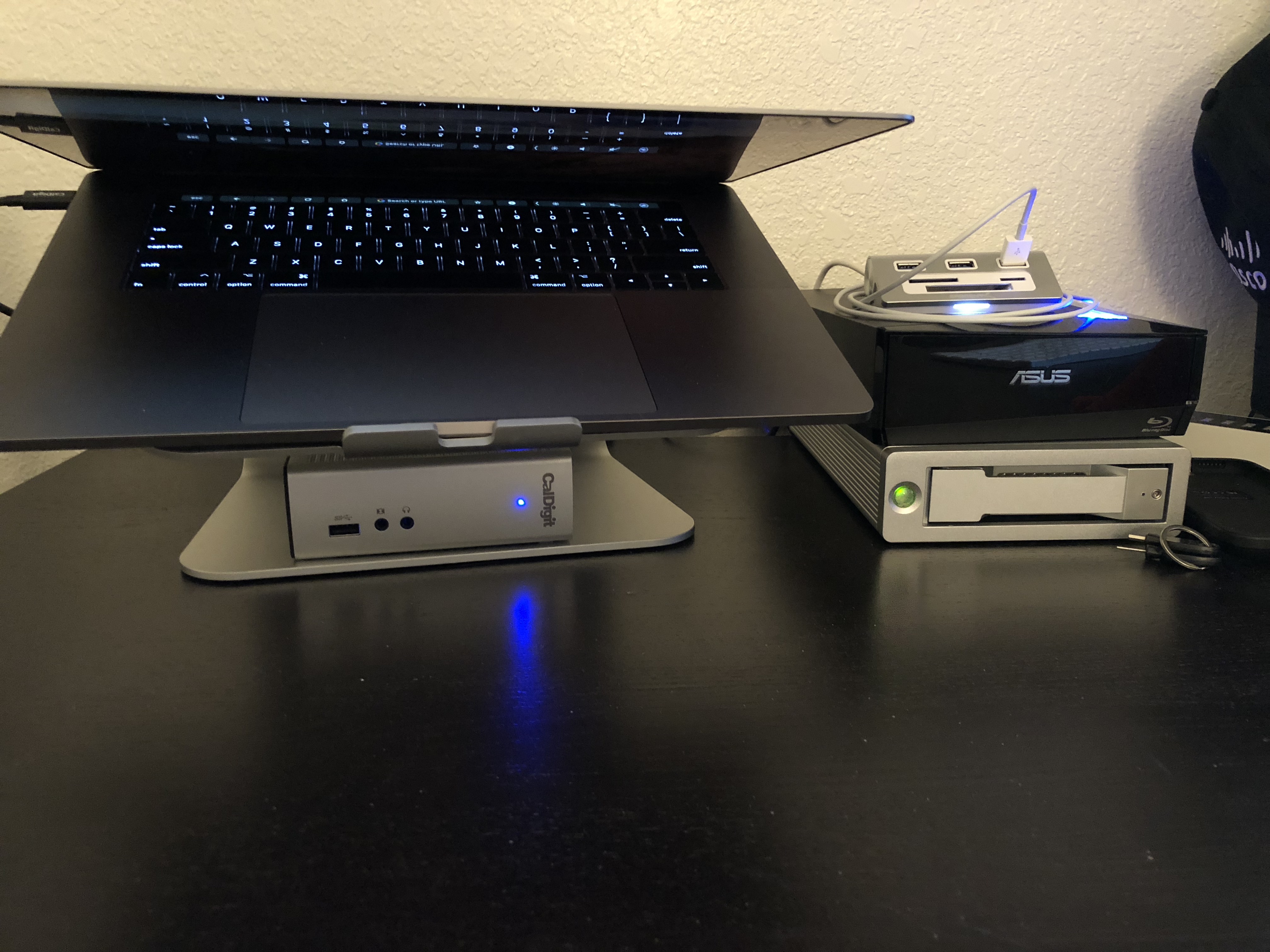

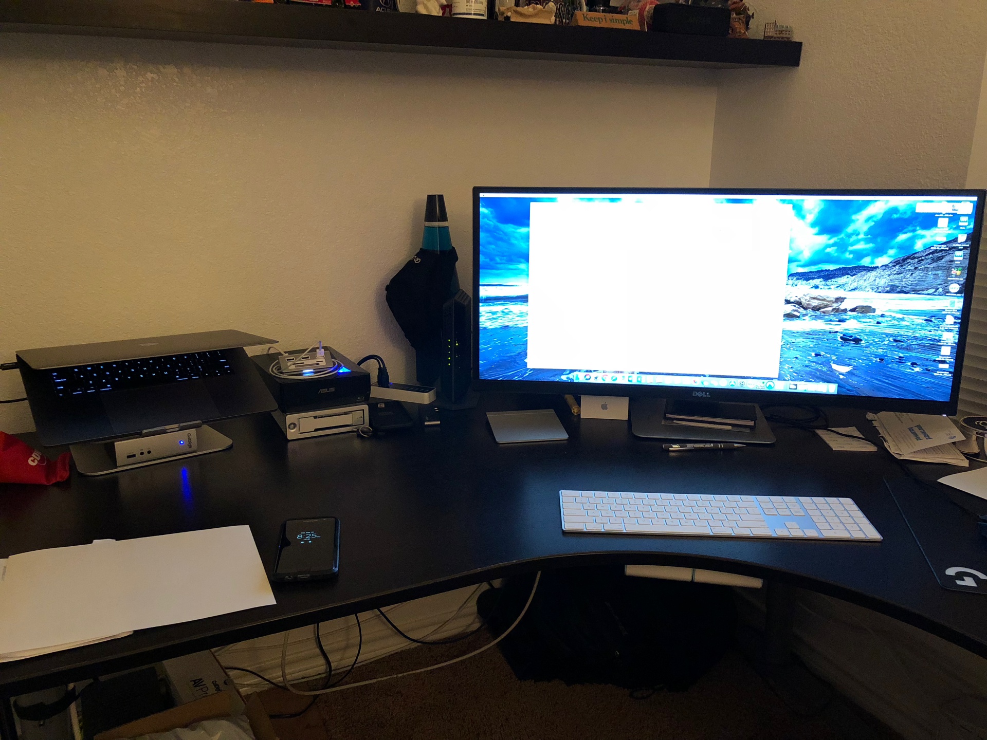

Get the Caldigit TS3 or TS3 plus dock. you won't have these issues with it. I run a U3415W which is almost 4k resolution on mine with no issues. I had the Elgato TB3 dock which is the same internals as the Belkin, and had issues with it. I also run a 2017 MBP 15" and it charges it great!
Also, a cable has a lot to do with it per Caldigit support. That maybe also why those other docks had issues due to poor quality cables.
