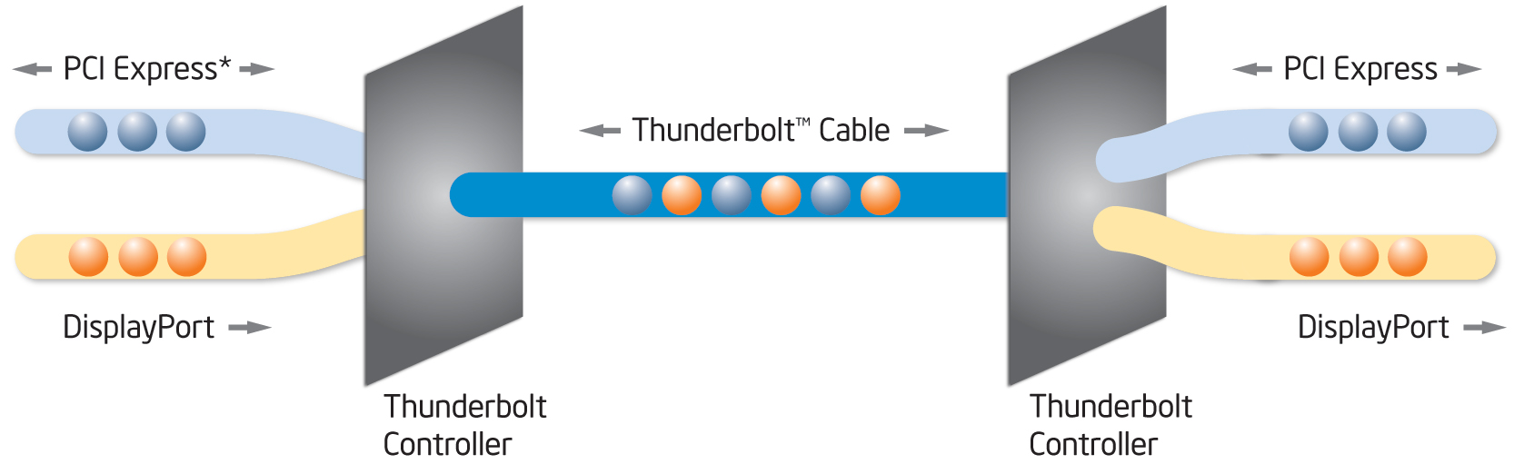

I can confirm that those work absolutely fine. The protocol used between the dock and computer is, has been and most likely always will be Thunderbolt. There is no DisplayPort, USB, Ethernet, etc. These protocols are encapsulated into Thunderbolt by the TB device and the computer will undo that. The same applies for the other direction.
You may want to read some of the info posted on the official Thunderbolt website. They have some videos, infographic, etc. The best image that shows the encapsulation is the one Intel showed when they introduced Thunderbolt:
