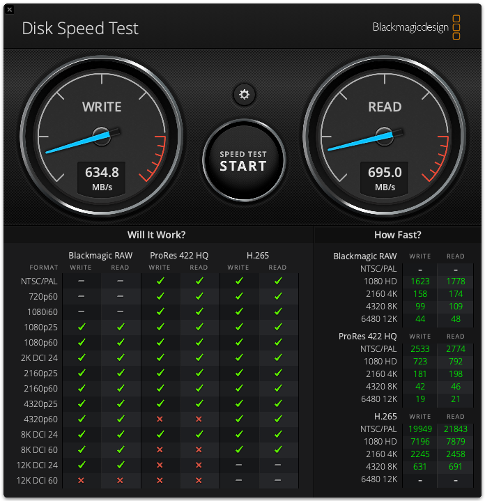

I just bought an Acasis Thuderbolt 3/USB4 External SSD Enclosure and put a Samsung 880 Pro into it. I have it as a second external SSD for my Mac Mini M1. I have just tried the setup suggested above, using my Caldigit TS3 Plus, connected , via Thunderbolt 2 to Thunderbolt 3 Adapter, to my Late 2013 MacBook Pro 15" Retina. 16GB Ram 500GB Internal SSD. The Internal SSD gave this:

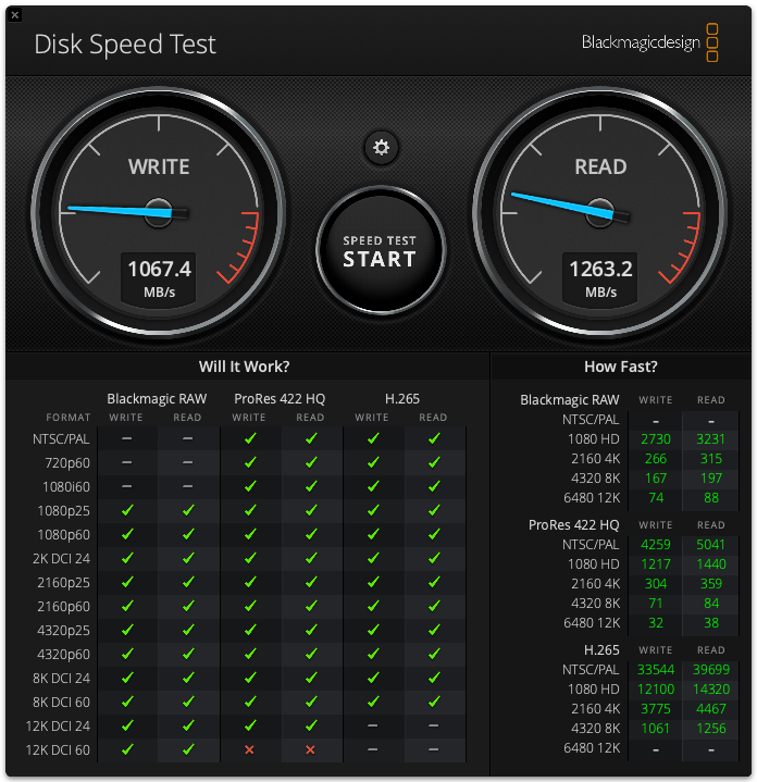

The Acasis / 980 Pro gave this:
Great speeds for an old TB1 Mac.
I didn't think that the TB1 Macs could get external NVMe speeds that high. I have tried with modified Samsung X5 on an TB1 Mac, and couldn't break 1000MBps read speeds. I always suspected that it was the dock I was using, the Caldigit TS3 Lite.
I might have to get a Caldigit TS3 Plus and see if I can improve the old Macs' speeds.
Probably not worth the investment, but if one plans on using the dock and external SSD with a newer Mac when they eventually upgrade, this set up could bring new life to an old computer.
Thanks for posting this.
The 2013 MacBook Pro 15" is Thunderbolt 2, so that undoubtedly explains the speed difference between this and an older Mac.
You are correct, my mistake.
I quickly read the post while on an elevator and responded to it when I got back to my desk. I thought I saw a Late 2013 iMac, not a MBP.
I don't have any TB2 Macs to test, but I was thinking that a NVMe over TB2 would have performed higher than what @MikeFAB posted. Still really good for an old Mac, but a little disappointing considering the Samsung X5 over TB1 isn't that far behind.
