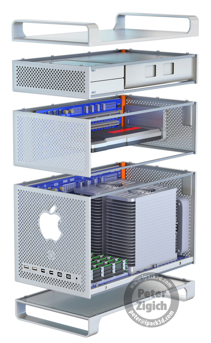

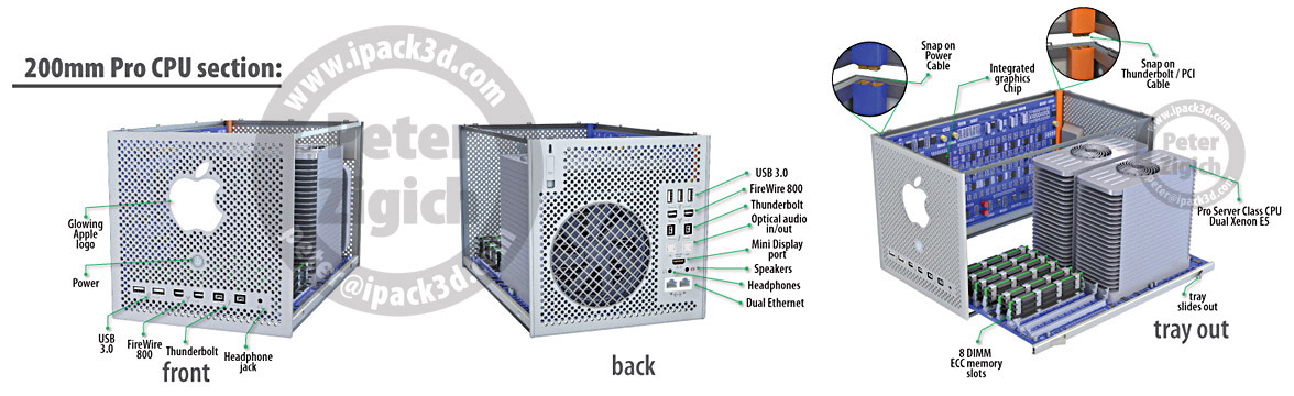

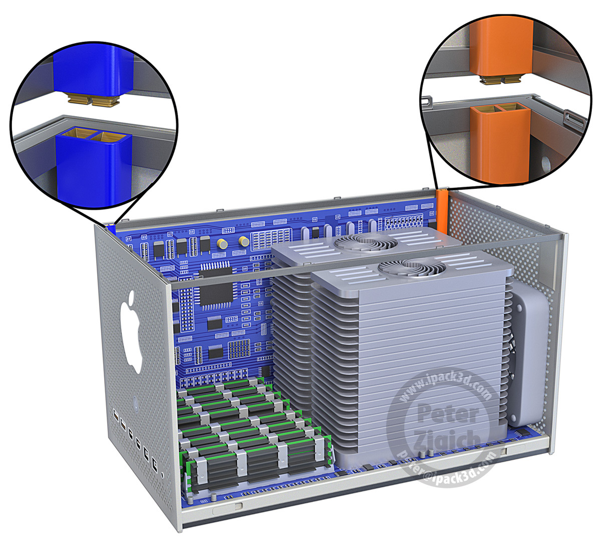

Here's how Peter imagined it for example:
http://ipack3d.blogspot.jp/search?updated-max=2012-09-29T21:48:00-04:00&max-results=8
There are a lot of technical reasons on why this is an insanely bad idea for a power machine. Every connector could introduce data degradation and electrical strain points. The more sections you add, the more unstable the machine would become.
For weaker, lower power devices, you might be able to pull it off. But a machine chucking all that bandwidth and power around? Not going to happen.
Naw, I don't think so. It's not like the boxes would be hanging off in space or something. The hard drives, the RAM riser boards, and the CPU daughter cards all use very similar systems. You basically saying any one or all of those are unstable and " an insanely bad idea for a power machine" yet we all use them every day. 😛
Have you seen the CPU connector on the daughter card? There's over a hundred contact points on that sucker, plus several large ones for high current DC power. A single PCI-e 16x slot has over 82 conductors.
That "prototype" I keep seeing is so horribly thought out I don't even know where to begin with it. I can't stand industrial designers who throw out garbage like that and forget about all the physical implications of an idea just because it's not convenient for the design. Seriously, two connectors for both a high-speed data bus and high current power supply? He doesn't even address the latching system that would be required to solidify removable modules into a stable monolithic configuration. All it shows is a bunch of tiny latches that give you the impression things are supposed to hook together, without actually detailing how such a system would operate- the mechanics behind that kind of thing are not trivial to get right.
Apple excels at hardware design precisely because they know what their ideas entail as a whole while they're designing them. The Mac Pro's case latch doubles up and secures the ODD and disk drives as well as holding on the side panel. A design decision like that requires foresight and planning. I see none of that in the prototype posted above.
The more connectors you add to a system, the more unstable it becomes. You've gone from a solid configuration of a Mac Pro tower to a whole bunch of stacked modules. Let's assume that it was designed properly (realistically) and you had a 200 pin edge connector on each PCB that mated with the module to the top and bottom, plus another 20 pins for power. That's 220 individual connections that need to be perfect.
Add four modules and you've got 3*220 = 660 individual points that need to be electrically operable, otherwise your system will crash or fail to boot. Why the hell do I want that? People seem to forget that systems like the SNES and N64 used edge connectors for their game cartridges, and occasionally needed to be reseated because the system wouldn't startup properly. Do you really want to have to dismantle your modular tower on a monthly or weekly basis because something shifted a bit (vibrations from a DC fan or hard disk drive), causing one of those 660 connections to become intermittent?
