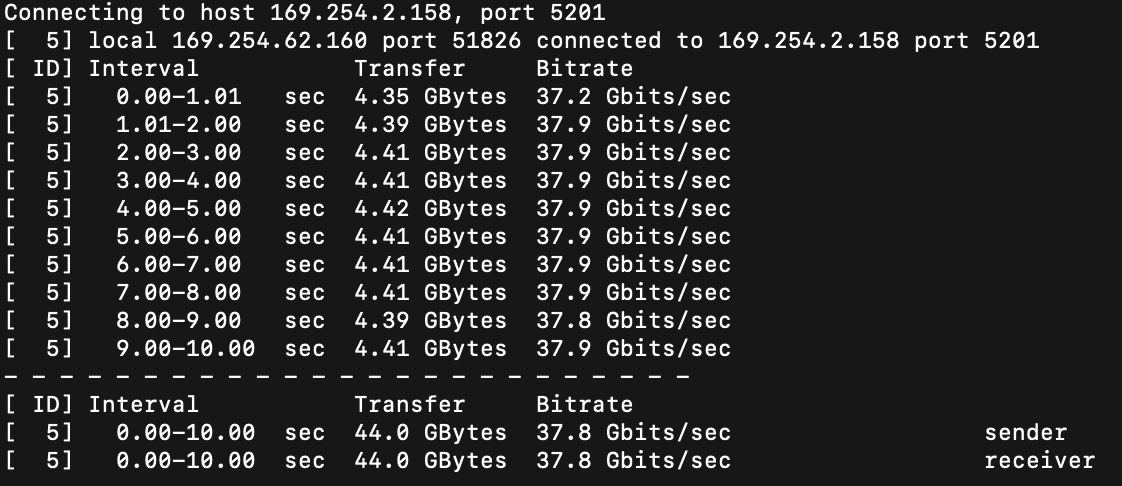

So I installed homebrew and then iperf and I get the following - which suggests the connection is in fact working at close to the link speed.
I am now beginning to think I am doing something sub-optimal in how I attempting to connect the two computers. I don't know much about networking, but I think have set up the connection in both Finder and Forklift using "smb" protocol. I wonder if that is the problem? If that is the problem, what is the best way to connect (and how do I do it)?
Wow, that's more than I expected. This may be a result of USB4 and improved drivers rather than older Thunderbolt 3 stuff.
