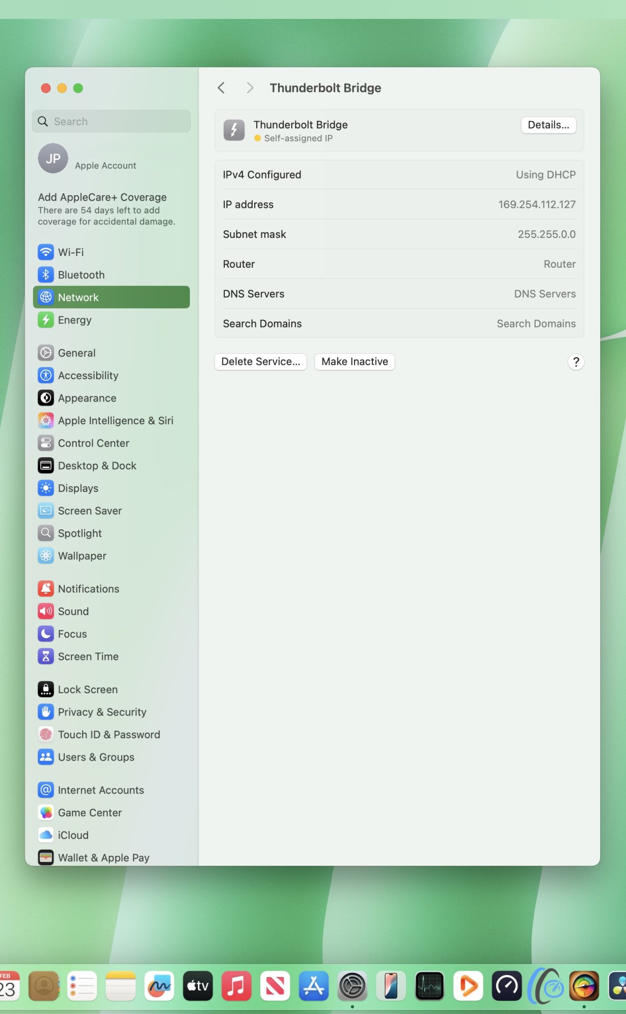

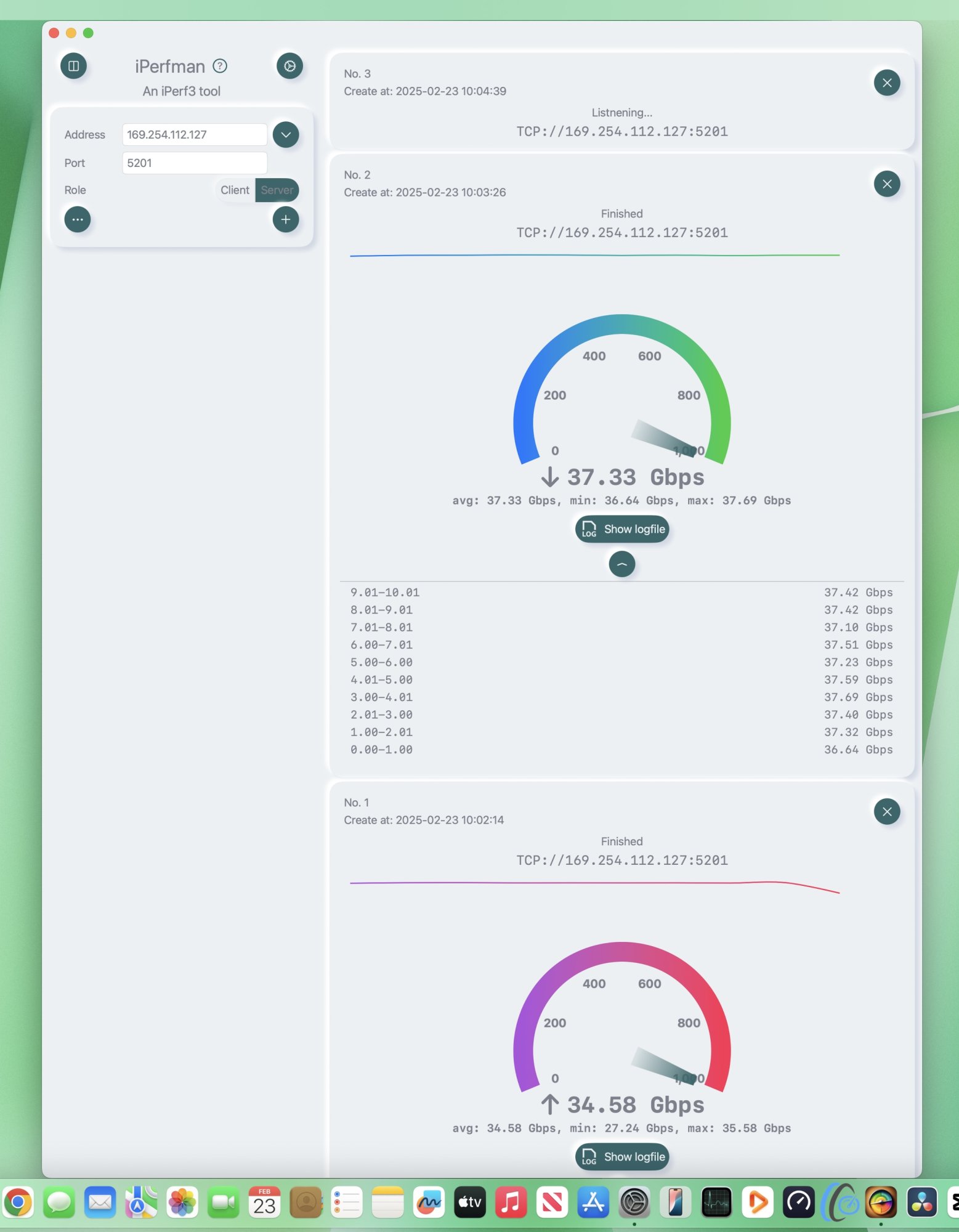

Here is my test .
iMac m4 and MacBook m1 connect thru thunderbolt 4 cable.
