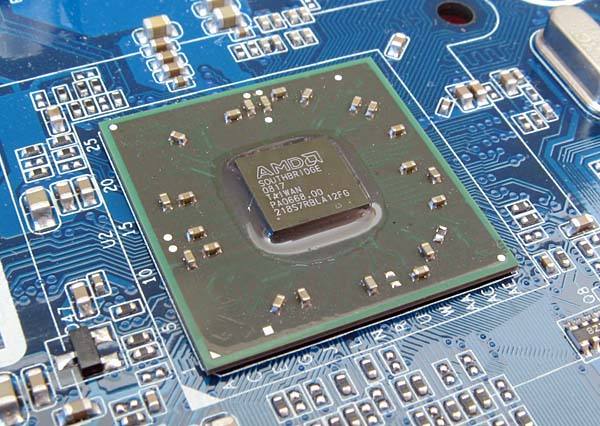

Just because it looks like a CPU doesn't mean it is a CPU.
Would you call a north/southbridge a CPU?
Sure would!
It's not a general purpose CPU, but it's a CPU. That's why the distinction exists.
A North Bridge has a clock rate, onboard memory, a state machine... what else does it need to meet the classification of a CPU?
