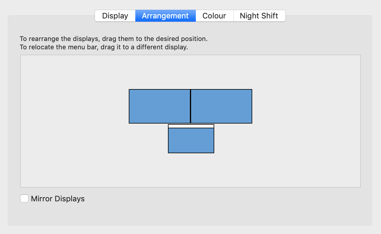

Monitor on the left is connected to Thunderbolt but has a dark screen.
Monitor on the right is connected to HDMI and works fine.
Any monitor connected to HDMI works perfectly.
Monitors connected via Thunderbolt all show black screen.

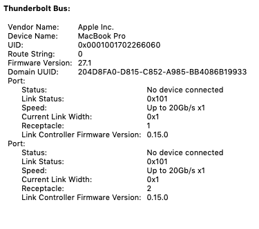

[doublepost=1566028945][/doublepost]Just tried with my MacBook Air and it works.
And at the same time it says that there are no devices connected.

Maybe a hardware issue with the Mac, if you’re using the same cables etc and it works ok on another machine.
