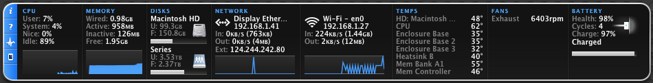

    Was bragging online about all the advantages but while writing I noticed / heard the display has a fan and it was loud!
    Didn't expect this. I thought the MBA fan would do all the work. But it is still silent.
    Right now I am running Spotify, Photoshop, Safari, Screenflow and iMovie. The MBA (2011) doesn't care, the temp is fine:
    [​IMG]
    Two hours after I unpacked the screen, the fan relaxed a little and the noise is becoming less annoying.

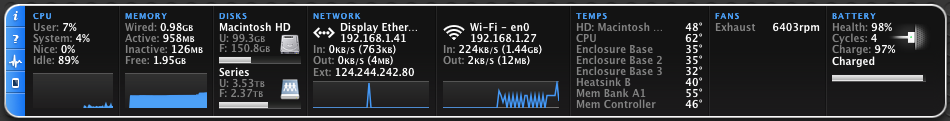

    still same problems
    i still have the same problems with the fans and the display. I used the 24 inch cinema display yesterday and things are fine but with the TB display the fas are up and loud. see screenshot.
    Any clues?
