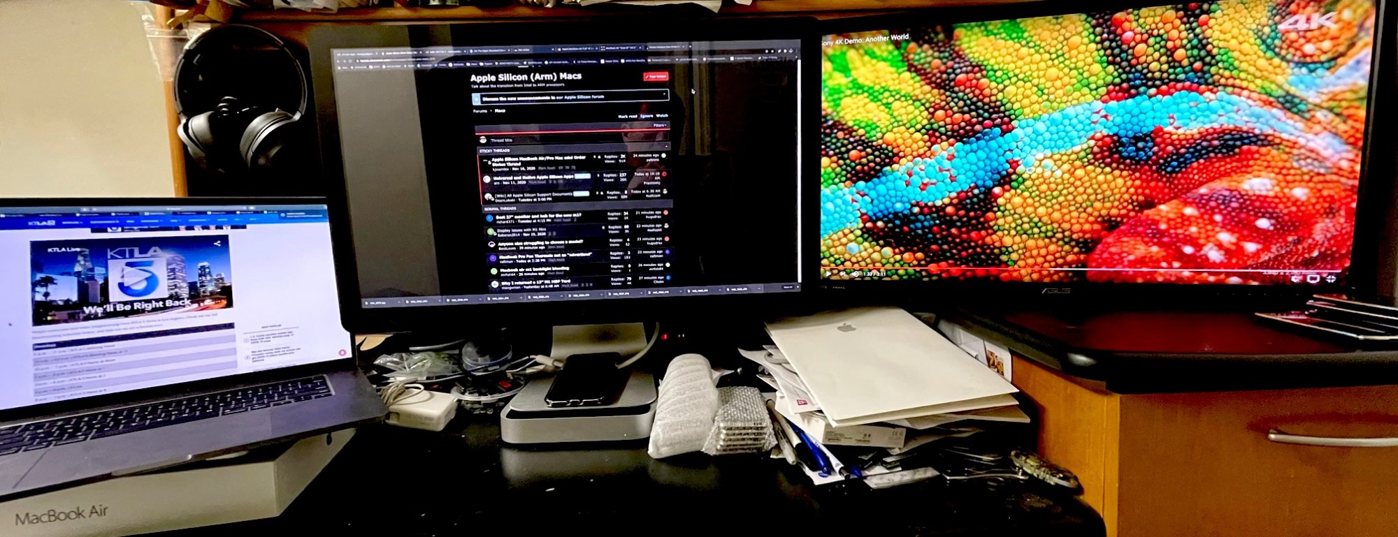

Here's my M1 Mini connected to a 27" Thunderbolt display (center) using Apple's TB3-TB2 adapter and 27" Asus (right) connected straight to HDMI, and my 16" MBP it was replaced (left) due to heat and small screen:
