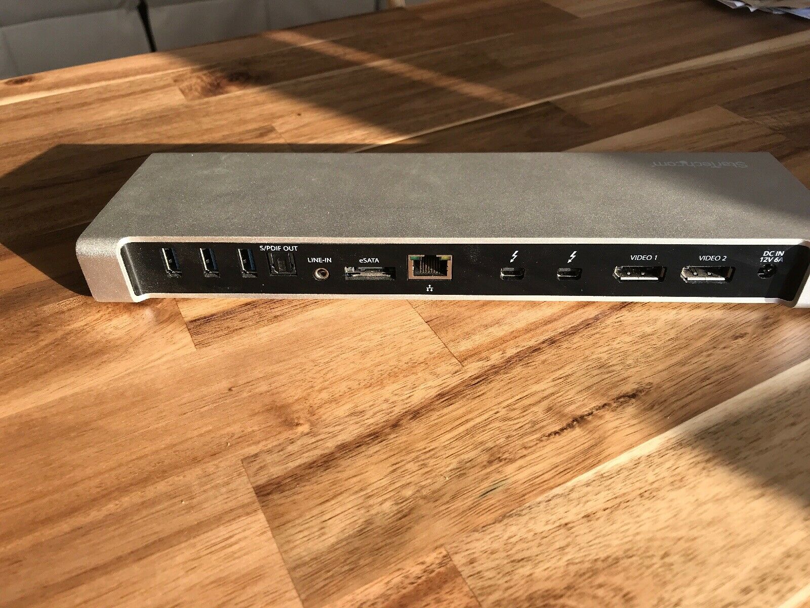

I have just bought this dock on eBay. I did not realize at the time it was a Dual Monitor.
What my question is it has 2 Video connections is that the same as a Display connection?
Because I can,t see any leads that just call themselves Video connectors?

I have just got the answer to my question.
Get your work done faster, with dual-video support through two DisplayPort connections Why don,t they just call them what they are rather than just calling them 1 Video 2 Video?🙁i haven,t seen many reviews of the dock I am getting. This is the one I thought I was getting
I am wondering do i buy a Display port to hdmi Cable or
Display port to Hdmi Adapter
or active or pasive?
I am tottaly confused by it all.🙁Display port on my Thunderbolt 2 Dual Monitor above,i must say i only have one Monitor at present.

(I'm assuming you have this hub and a Mac with Thunderbolt 2 ports, not a new TB3 one).
Short answer is that this dock won't support dual monitors on a Mac unless one of them is a Thunderbolt Display*.
For your single monitor - you either
(A) connect it to the "spare" Thunderbolt port on the dock, using the same MiniDisplayPort to HDMI/DisplayPort/DVI/whatever adapter that you would use to connect it directly to a Thunderbolt 1/2 port on a Mac.
Or
(B) you can connect a monitor with a regular HDMI cable to the HDMI port on the dock.
If your monitor already has a HDMI cable, or you have other Thunderbolt devices to connect I'd go (B) - otherwise (A) because the same adapter will work directly in the Thunderbolt port on your Mac.
Active vs. Passive: For (A), a 'passive' MiniDisplayPort-to-HDMI adapter will support displays up to 1920x1200 (including 'Full HD' 1080p) but if you have a higher resolution display - such as 2560x1440 or 3840x2160 - you need an active adapter. For (B) the HDMI port on the dock is apparently supports up to 4k@30Hz so it must use an internal active adapter.
* Or if you connect a second thunderbolt 2 device - another dock or a TB disc drive with two TB ports - and run the second display off that.

My Mac Mini is a 2012 model so ir is Thunderbolt 1.What i ment to say above is that i did not know what Video conections were untel i looked on utube and saw that they must be Display ports ,i have no idea why they don,t say Display Port on the dock?
I have to say i just received it today it looks in excellent condation it feels a good pieace of kit.🙂
