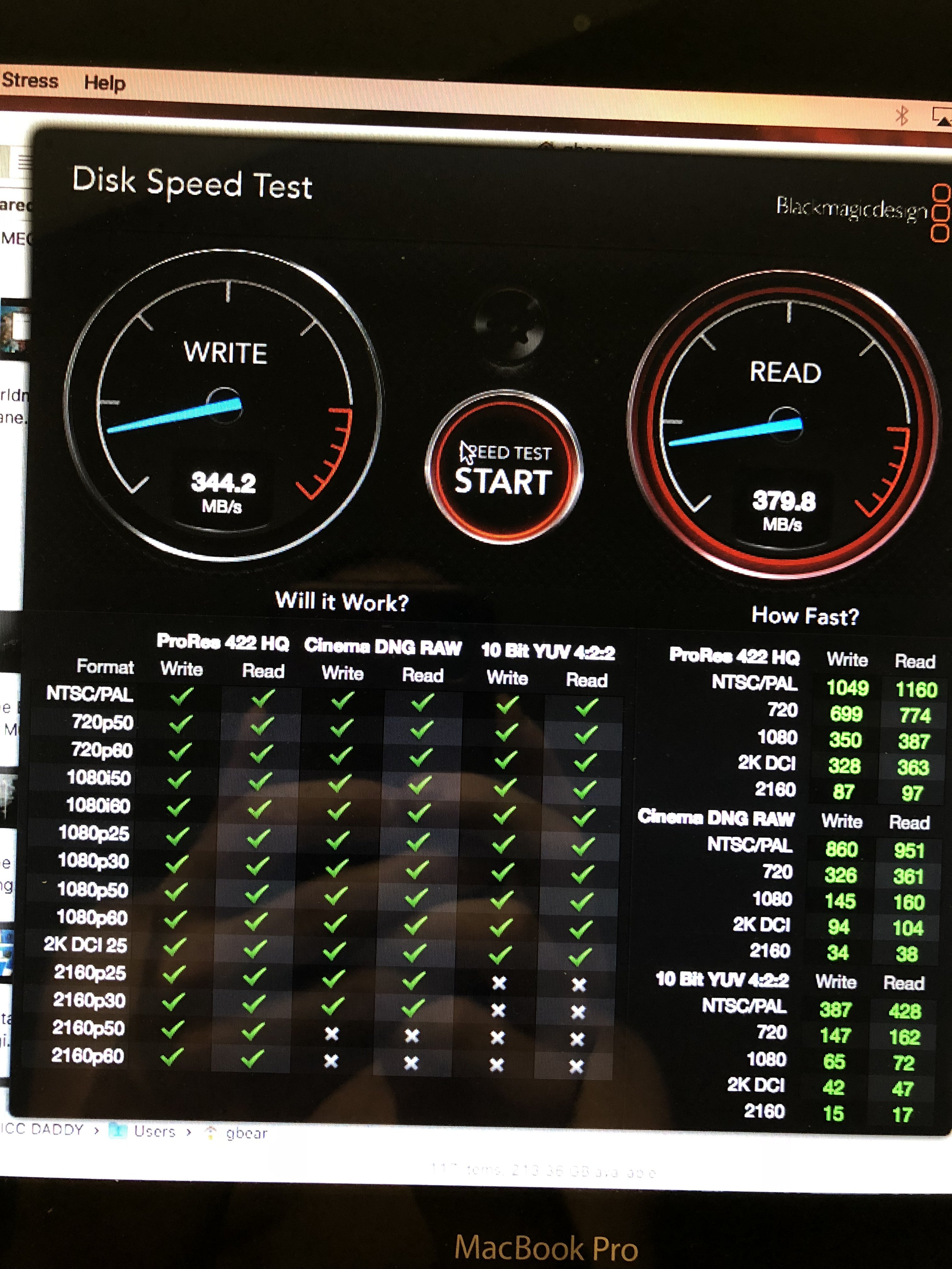

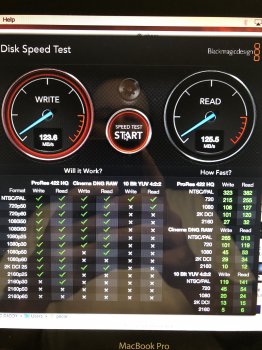

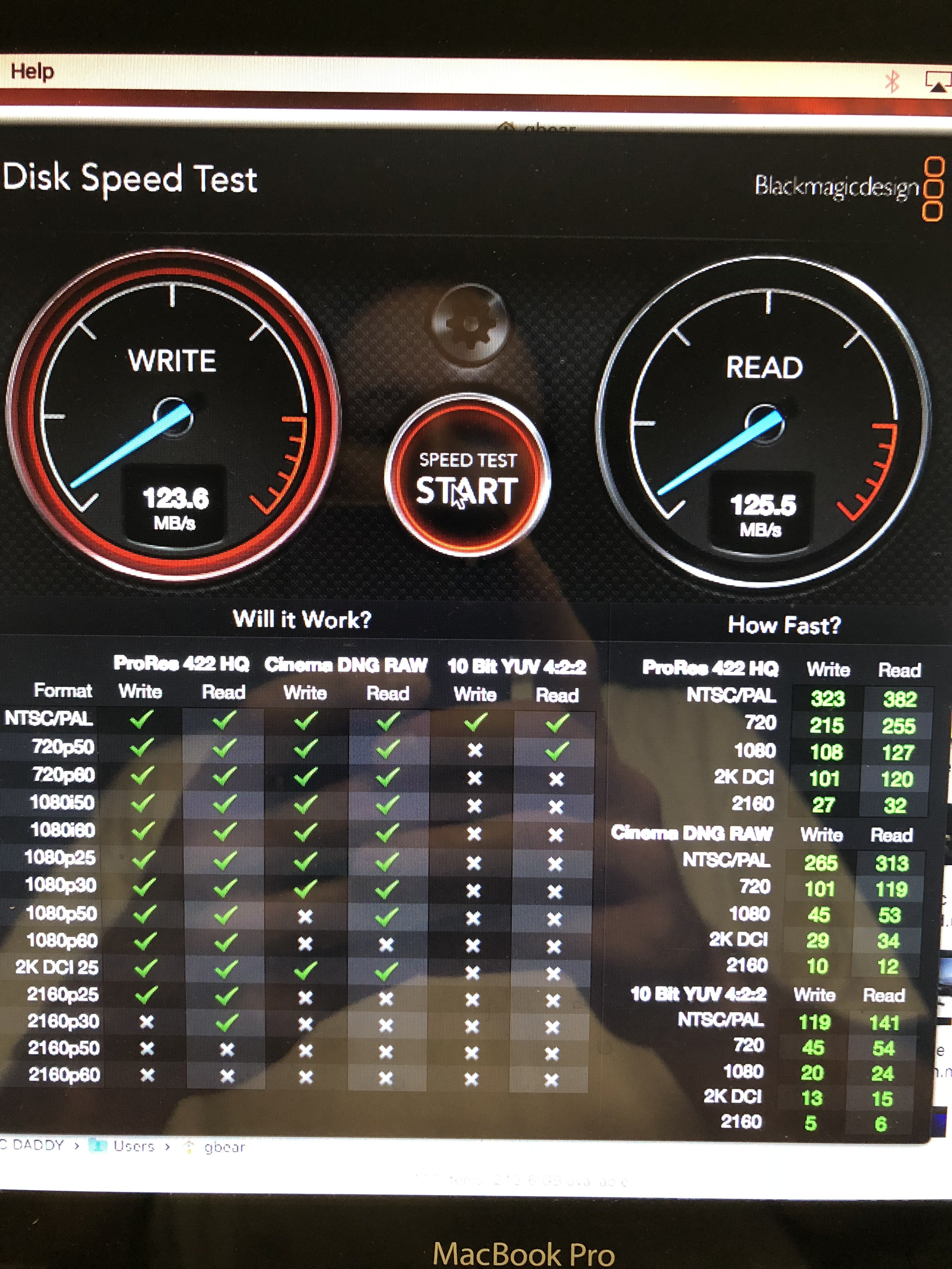

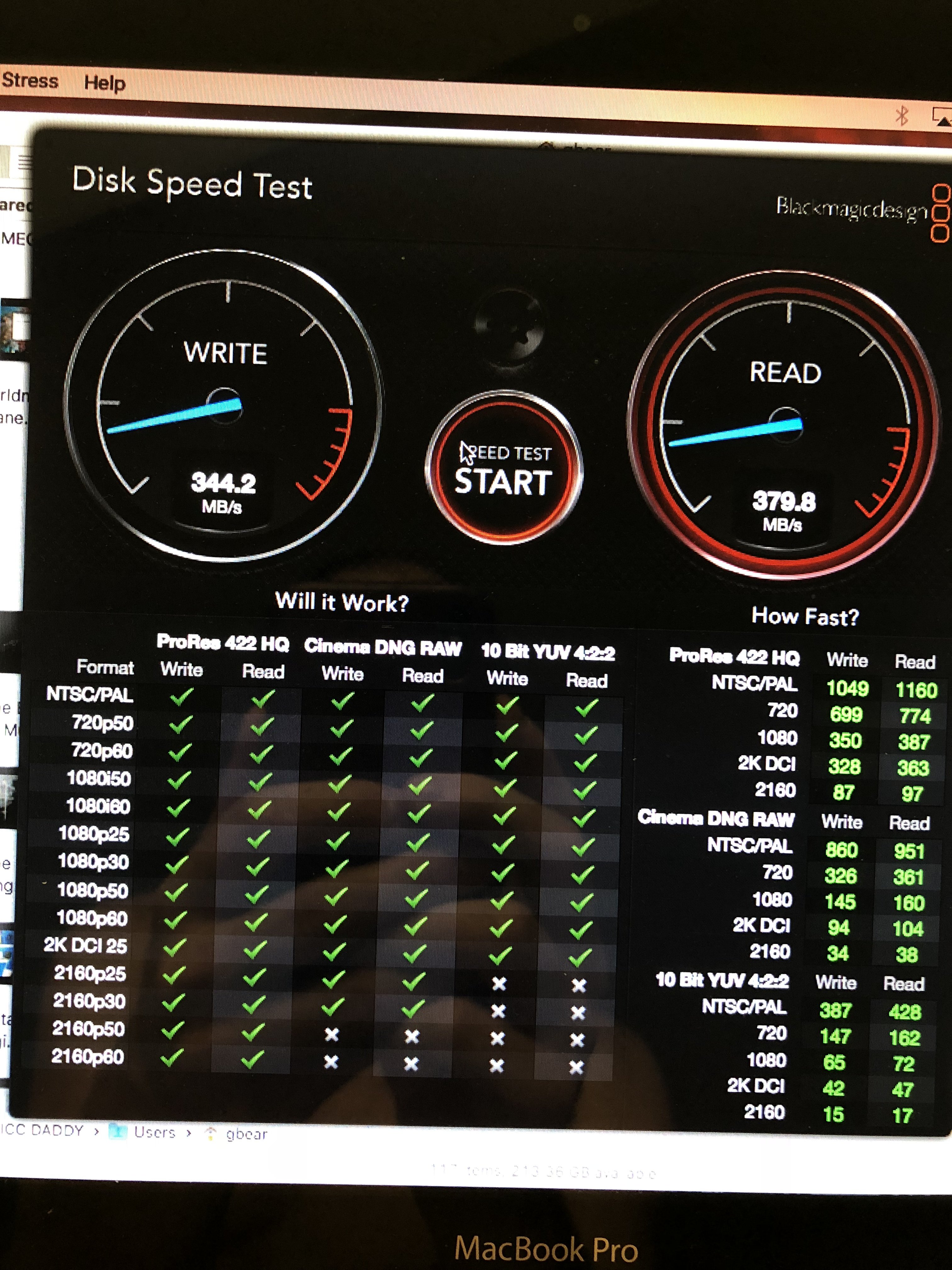

Over the weekend I swapped the mechanical disk out with the ssd into the LaCie enclosure and these are my results.
The stock LaCie drive is on the left and the 860 EVO 1TB SSD on the right. Night and day difference. This was tested on my 2011 MBP, although I am curious but not sure how much faster it would get on a newer MBP with TB2 or TB3.

Frankly, the speeds you posted in reply 11 above aren't all that great.
Get a USB3 enclosure that supports UASP (USB attached SCSI protocol) such as this one:
https://www.amazon.com/MiniPro-Exte...sr=8-1&keywords=oyen+minipro+usb3.1+enclosure
Put your Samsung EVO into it, and you should get read speeds of about 430mbps.
Your experience provides one more illustration as to why thunderbolt IS NOT "faster than" USB3 with the proper hardware.

I think you fail to recall that I do not have USB3 capabilities so it is not possible for me to get those quoted speeds.
