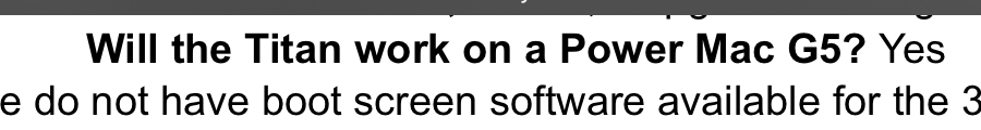

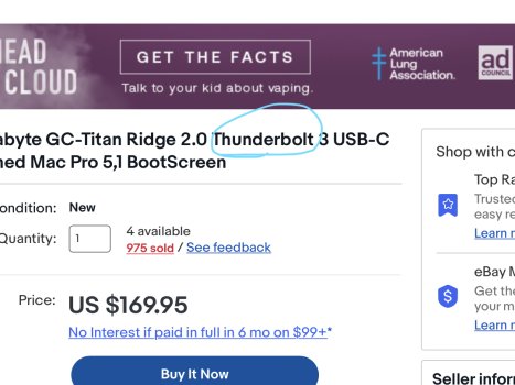

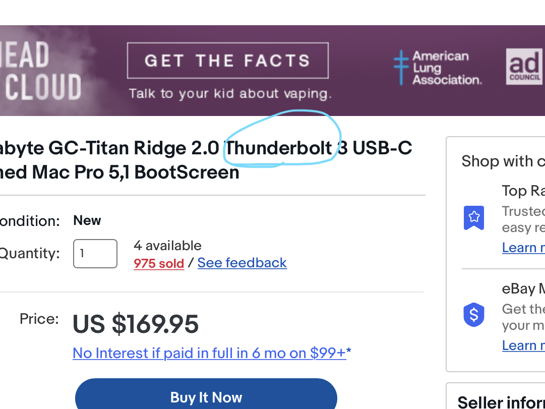

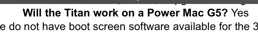

No, this is not clickbait look. 😳 Anyone wanna try it?

I don't believe this. It's highly likely to be a typo or just incorrect.
Thunderbolt needs to be initialised by drivers for Thunderbolt devices to work in macOS. The listing itself says Thunderbolt functionality only works in macOS Sierra and up; only USB-C functionality is available on El Capitan. On Tiger or Leopard, neither Thunderbolt nor USB-C functionality will work due to missing drivers. Maybe it works in Linux on G5s.
🤷‍♂️ I haven’t tested it. I don’t have a G5. (Though I hope too)
