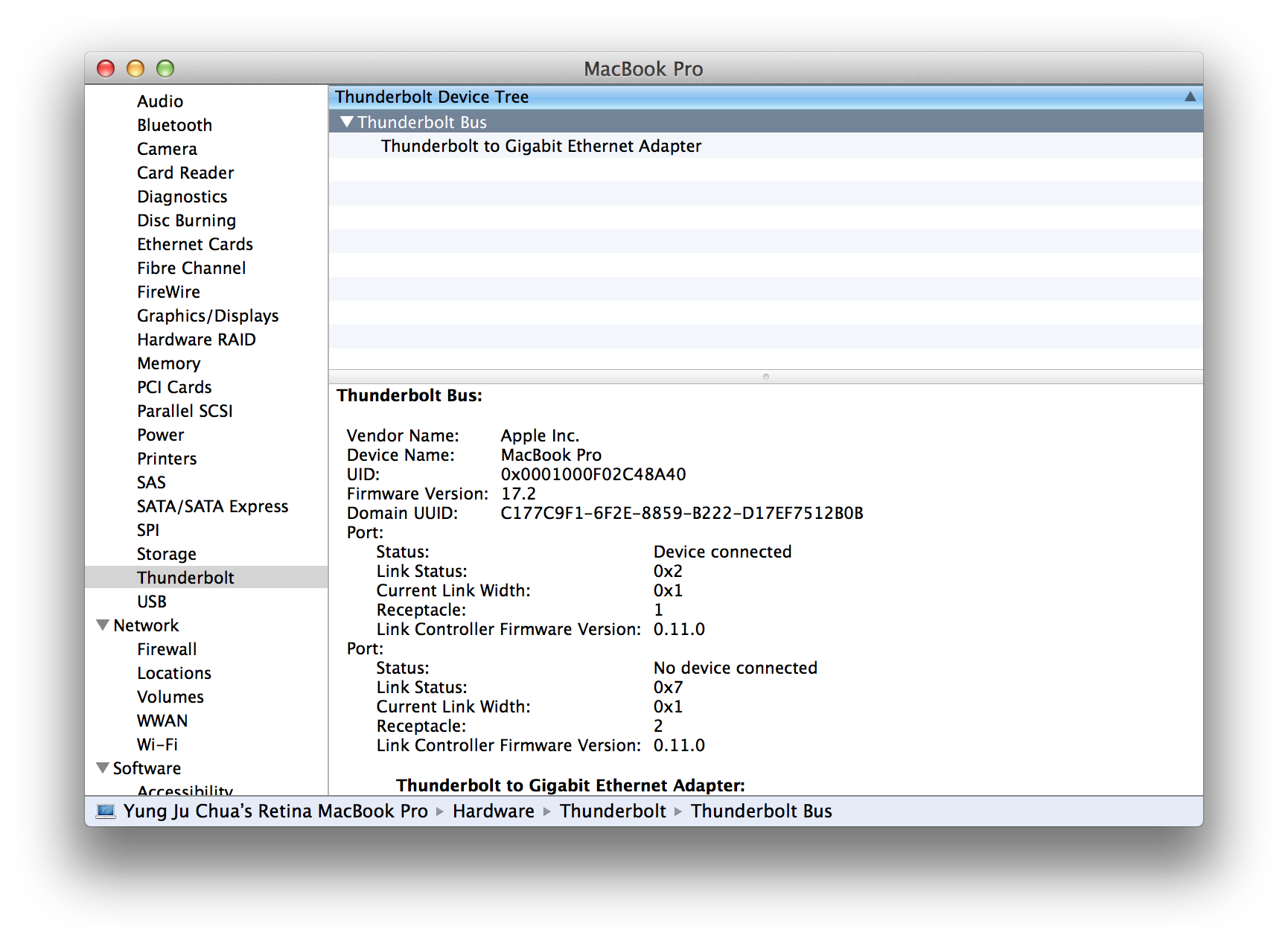

Well, based on my experience you shouldn't be seeing the TB ethernet adapter in the Thunderbolt section of system info, it will show up in "Ethernet Cards" and show as being connected to a Thunderbolt slot. Do you see anything when you look there?
Actually, the TB-Ethernet adaptor does show up under TB in System Info.

As RichardF and dwright1974 said, I had some problem with my TBolt-GigabitEthernet adapter related to IPv6. It was like if it didn't worked, but after changing some configuration it started to work.
